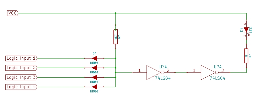

I thought about something like a wired AND
The problem with that is that this circuit expects the input to be either logic 0 or 1, if a single input goes low, then the associated diode passes and drags the pull-up down causing the input of the gate to go low.

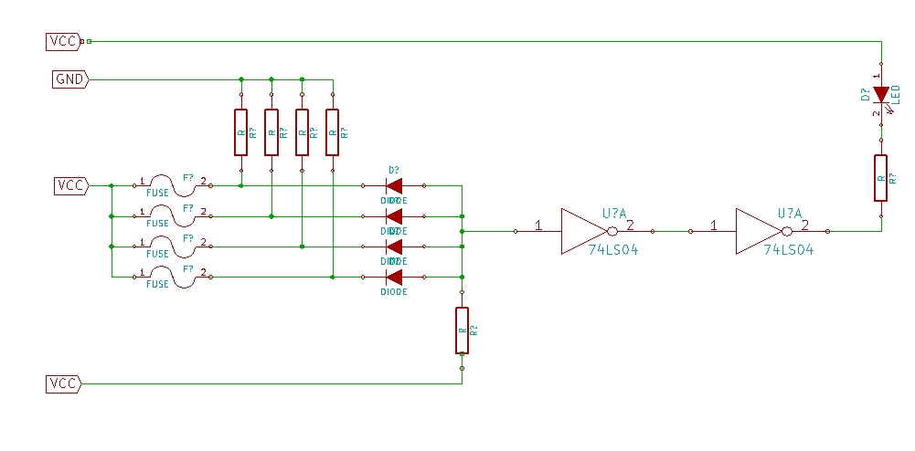

I thought that something similar could be used for my problem, however, if a fuse fails, the line would not be pulled to a logic 0 and the logic input would continue to float. I wondered whether I could find matching values for the pull-up and additional pull downs that would allow this to work, something like :-
However, I can't find a combination of resistor values that allow this to work, so I'm thinking that what I am trying to do is probably not possible.

The second schematic is not very well drawn, but the 4 resistors ARE pull-downs.

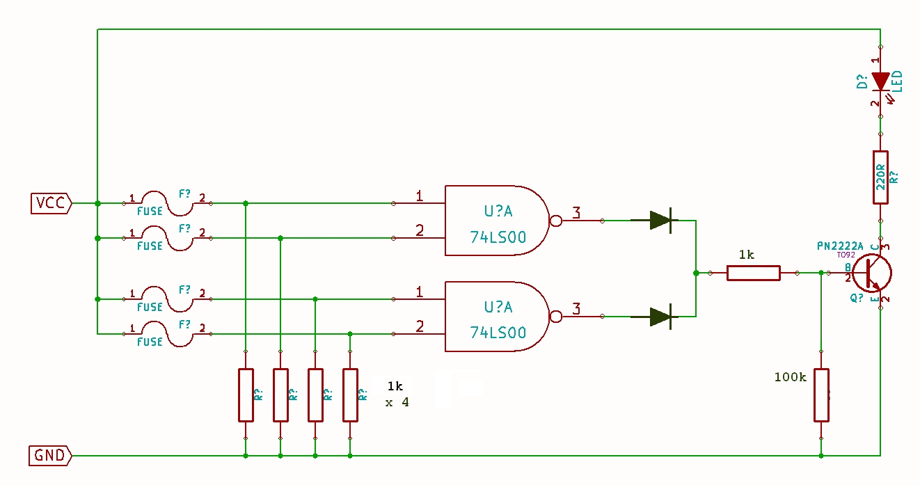

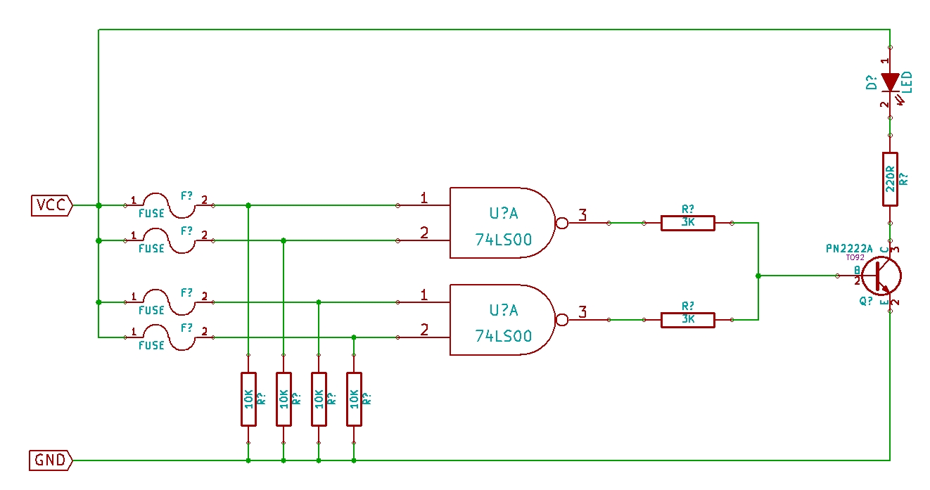

You could use the two 2-input NAND gates to monitor each of the 4 voltages directly with a pull-down resistor on each input. The problem is that ORing the high output voltage of these gates when any input goes low may not be enough to drive the LED. If you can add a buffer NPN transistor such as a 2N2222 for the LED then the NAND gates can be ORed to the transistor base input with a 3k resistor from each NAND output to the base of the transistor. The transistor emitter is grounded and the collector drives the LED and resistor going to +5V.
Then use two LED's, in a single package :)
Also, if a transistor can be added the diode/resistor logic circuit will work too.

thanks a lot for the reply and the suggestion, is this what you had in mind?
If I have drawn this right, could you maybe explain 3K resistors please?
I guess the intention is that if only one of the gates is high (single fuse failure) we need to ensure that the combined output is enough to turn on the transistor, but I'm not sure what's happening?

Use two diodes on the outputs instead of 2 resistors, then one resistor in series with the base. Might also need another larger resistor like 100k from base to ground to ensure the leakage of the transistor can not turn itself on (a standard design technique).

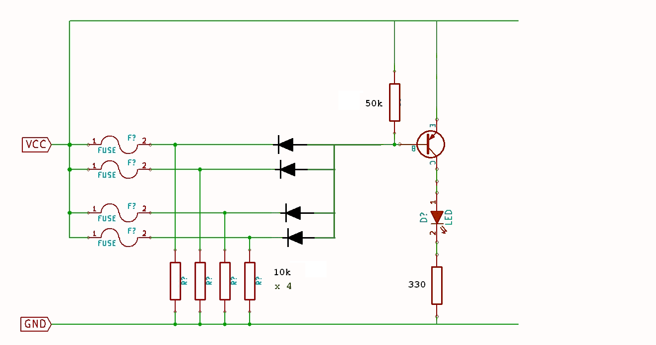

I see you use used 4K7, which seems to be a pretty standard value, it's probably not significant, but 4 x 4K7 would use about 4mA, using 10K would halve that, would it have a material impact on the operation of the circuit?

Actually i think the rule for LS TTL is 0.5v and 0.4ma per gate input, so that means even 4.7k is too high. 1250 ohms is the highest value that should be used for a single gate:
R=0.5/0.0004=1250
Remember that TTL pulldowns are always quite low in value. They have to be able to take the input down to some minimum voltage to ensure the logic sees it as a true logic low. To do that means we have to sink somewhat significant current.

Here's a new circuit that just uses one transistor and some diodes. It's basically a home brew four input DTL gate.

thanks for that - that looks like a good solution.
