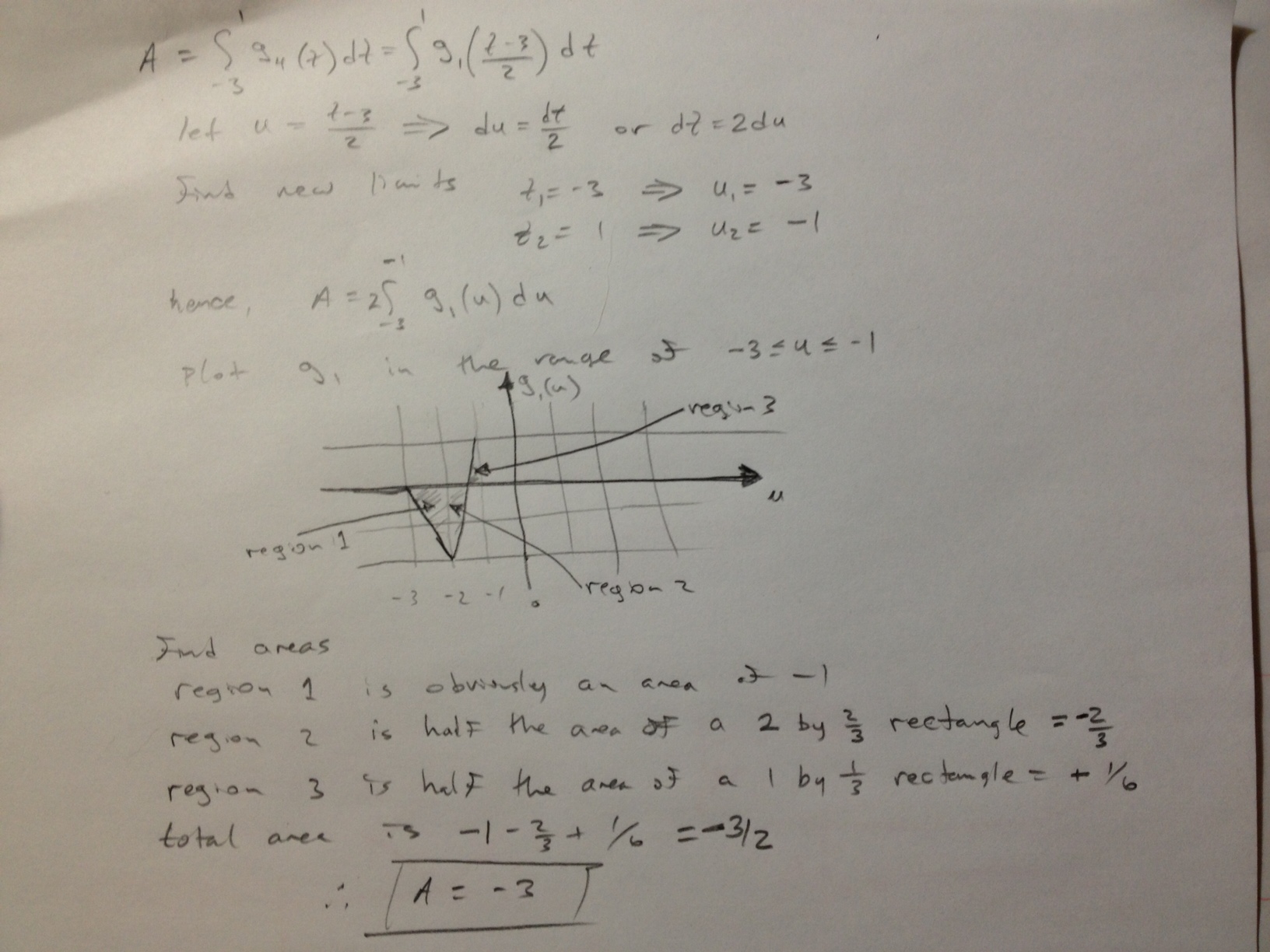

Somehow I got -3. You can double check my math and see if I made a mistake.
I use the substitution u=0.5t-3/2 which gives dt=2du and limits of u=-3 to u=-1
[latex]\int_{-3}^1 g_4(t) dt=2\cdot \int_{-3}^{-1} g_1(u)\cdot du=2\cdot \frac{-3}{2}=-3[/latex]
I tried to check your solution.
Your equation for CD, DA, AB, and BE are correct.
However, you did not solve for what is required.
Your solution shows the integral of g1(t) from -3 to 1.
What is required is integral of g4(t)=g1(t-3 / 2) from -3 to 1.
I think you missed a step.

@Steve: Thanks for the solution. The book's answer was wrong.

Hello,
Well actually the result for part d is really -3. So i wonder if the answers given in the book are to be taken as mutually exclusive.
The easiest way to see how this works is to first map the function g4 using g1. g1 maps to g4 as shown in the attachment in red.
The function shown in red is easily seen to have area equal to 3.333333 under the x axis and +0.333333 above the x axis, making the total equal to -3.000000 square units. A more accurate graphing shows this a little better though.

No problem. I can clarify what I did in this attachment.
Basically, the substitution is done at the symbolic level in terms of g1 and g4, so the nature of the function (continuous or discontinuous) is not important, as long as the functions involved are integrable.
After that, one could choose to break the regions down to have line-functions in each region, then write the equation for the line and then integrate in each region over appropriate limits. However, these functions are simple enough to determine the area directly by inspection.
To find the area by inspection, I generate 3 right-triangular regions. Knowing that the area of a right-triangle is half the area of the rectangle (defined by the short sides) allows me to find the area simply by noting the lengths of the sides of the rectangles of each region.

I got -2, with almost no work at all
I use the substitution u=0.5t-5/2 which gives dt=2du and limits of u=-4 to u=-2
[latex]\int_{-3}^1 g_4(t) dt=2\cdot \int_{-4}^{-2} g_1(u)\cdot du=2\cdot (-1)=-2[/latex]
The region from -4<u<-3 has no area at all because G1 is zero in that zone. And, the area under G1 from u=-3 to u=-2 is trivially equal to -1.
