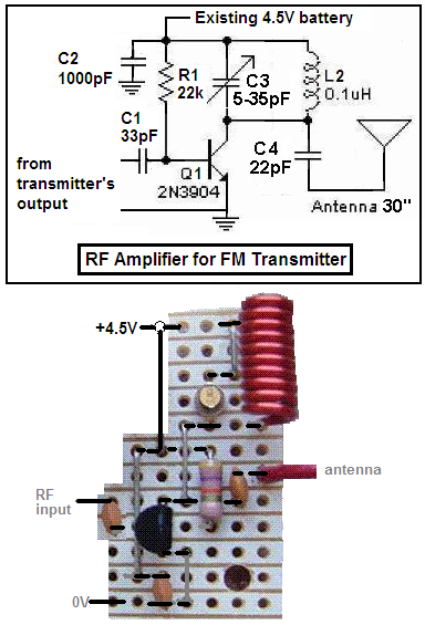

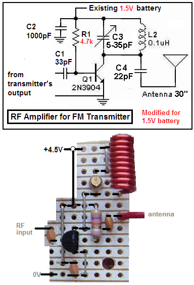

Here is the RF amplifier from my FM transmitter with the base bias resistor's value reduced for only a 4.5V supply:
A transistor with a parallel tuned circuit for its collector load has high gain.
A transistor with a resistor for its collector load has low gain at 100MHz.

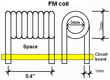

I got the enamelled wire from a speaker's crossover network. Here is how I make coils for 100MHz:

If a RF NPN transistor is used to amplify the modulated signal, with a resistor for the collector load, will the gain be high?
No it will be pathetic!, tuned amplifiers are used in RF circuits for VERY good reason!.
The gain of a transistor is determined by the ratio of its collector load impedance to its emitter resistance. At 100MHz the antenna is about 50 ohms to 75 ohms and is in parallel with the collector resistance so the voltage gain is fairly low.
When a tuned circuit is used as the collector load then the voltage gain is higher.

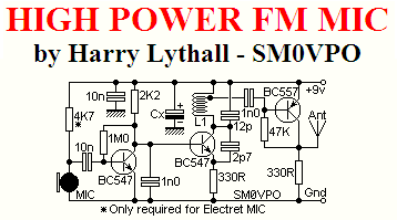

Harry has many FM transmitter circuits on his site. This one uses a PNP RF amplifier transistor with a collector resistor. Other transmitters use an NPN transistor and operate the same. He says the power gain is 10dB which is 10 times the power, but the oscillator's coil is tapped so its output power is low anyway.

with that rf amp posted by audioguru how do you know it's working and what does the variable capacitor do change frequency or what?
how far is the range if you know?
it is for tuing the paralle tuned LC combination so that only wanted fundametal frequecies are sent to arial and harmonics are suppressed, thus you have to peak it using your Rx as a sensor to get best distance, indirectly indicating that the coil and cap are properly tuned.

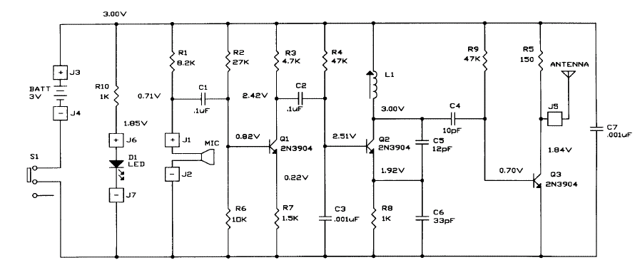

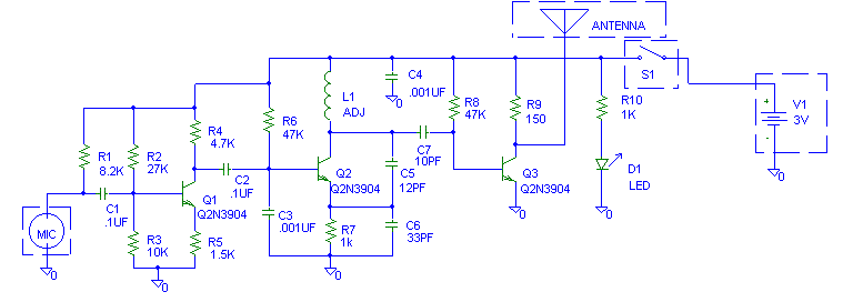

I just noticed that your flea-powered kit transmitter operates from only a single 1.0V to 1.5V battery cell!
So I have modified my RF amplifier to work on such a low voltage.
The RF amplifier might not make any difference or it might extend the range to twice as far.
You mean R1 value of ONE ohm to current bias 2N3904 from 1.5V DC???
PS: OK it is 4K7 , I get it

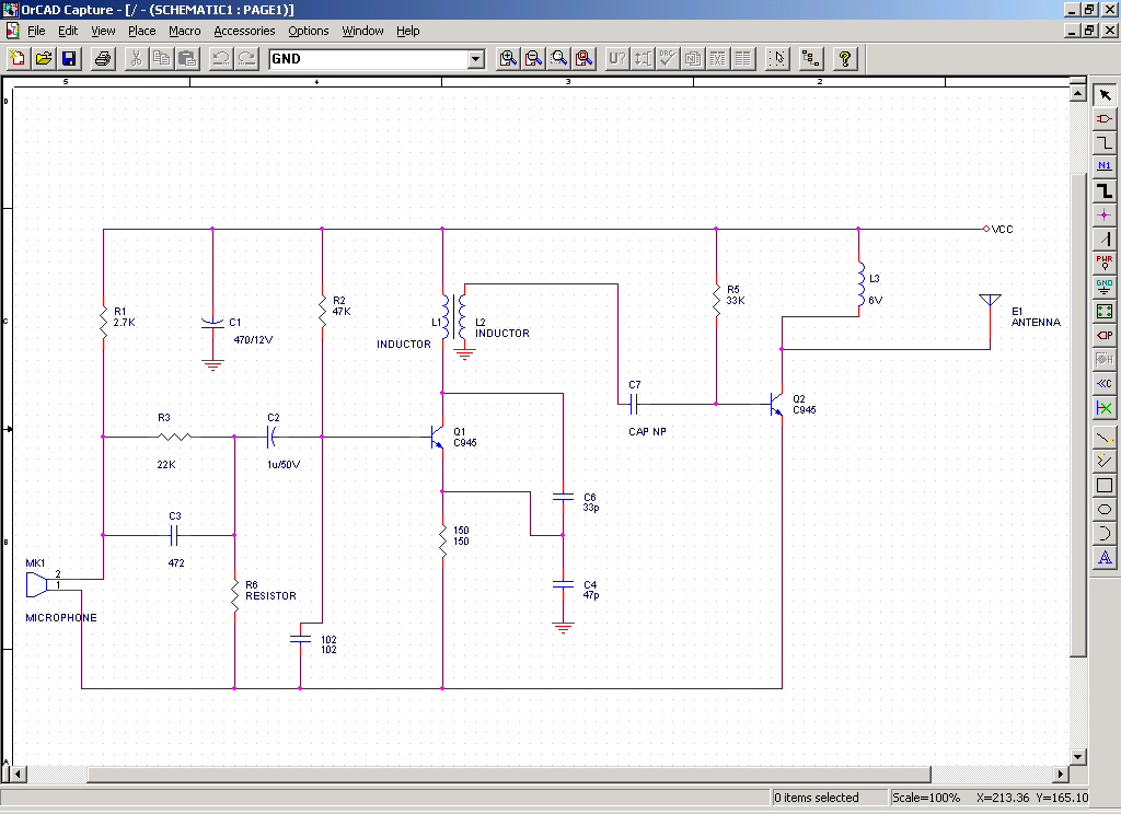

Well, I've seen some shematic(s) of the wireless microphone(s) on the internet. In these schematics, at the oscillator stage there's a capacitor 33pf(C6) or 47pf(C4) which is connected parallel with the resistor at Transistor's emitor's, I hope you could all see the schematics... well I don't know what do these capacitors do or take effects in these circuits ? Could anyone help me answering this question ?
Thank you all for answering this question ;)
It's an emitter resistor bypass reisitor, it increases the gain at VHF but keeps the DC gain low.
