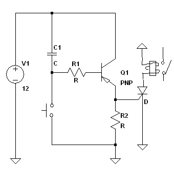

I would suggest that a relay would be more suitable than an SCR, and is more in keeping with car technology (and removes any PSU noise and spike problems). For that matter, why not just have a hidden toggle switch?.
1. A toggle switch would be a bit of a pain because I would have to remember to turn it off each time I get out of the car. With my idea all I would have to do would be to press the tiny pushbutton switch and I would be good to go.
Why the SCR instead of a relay? I dunno, I guess I just like the idea of an SCR better 8)
EDIT: One question that I forgot to ask: Do I need chokes on both sides? + and - ??

No, just the positive, the negative is connected to chassis.
Assuming you need a choke at all?.
Bear in mind that this needs to be a very reliable and trustworthy device!, you don't want your engine dying on you at a vital moment!.
I used to install car alarms, and its best to cut the starter wire because at some time the car will have engine problems. This way the car starts or dosent start and the alarm will never cause stalls or erratic operation.

I did what you said len and found that there are quite a bit of voltage spikes.
I would imagine that my supply should probably be relatively smooth, seeing as I am using a capacitor to provide the time delay, and the AC component of the signal (noise) will pass right through the capacitor. Of course the supply doesn't have to be perfect.
I was thinking of using a choke in series with the circuit to take out the massive voltage spikes, and then an capacitor from + to - to take most of the noise out. How does that sound?
I don't think I need to get into regulators and zeners for this project.
The choke idea sounds good, but I've had no experience in this field.
However, the other post that I referred to used a series resistor and a shunt 16 Volt Zener. This post was replied to by someone with automotive knowledge. It may be worth your while to send him a PM.

A very good point Nigel. That is why I am going to install a regular toggle switch on my circuit that will bypass the whole thing, just in case it somehow gets fried.

Instruite, here is the circuit I was talking about

Hi Zach,
I should mention that with SCRs,
although the gate is the most usual method of turning it on,
they can also be turned on by voltage pulses across them.
There are comraratively few circuits that use that as a method
of turning them on, but it is an established method.
Cheers, John :)

You can see on my schematic that there is a ground on either side of the SCR (one through the relay). The reason for this is that on both sides of the relay, I measure ground with my voltmeter. Will this not allow my SCR to work?

i can see you've draw a little arrow.
with no 'legend' or letter by it....
ah i see now you mean ground or chassis,
briefly, yes you are correct, you will need the supply to it,
probably to the topmost of your little arrows.
John :)
although i really don't think an electronic arrangement would be the best
solution.
Best of luck with it, John :)

If you were going to do something tricky with a timer for a delayed action on an EFI system, it could be effective and do something neat like give an audible siren a few sec before turning off the pump so you would figure out what was happening before getting screwed with losing power on the road. In this case, you need a switching element like a relay or a MOSFET.
I would recommend against an SCR. Any glitch in the current could shut it off and you might be on the highway at the time. Just a mechanical switch capable of holding the constant current of the pump will do the job.

Zach, the transistor should be an npn one.
Whatever the scr is switching should be connected between its anode and the 12V supply.
