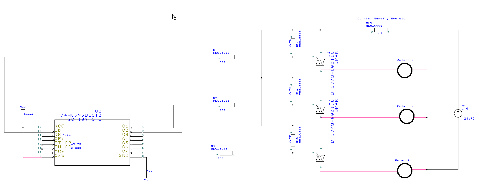

I need a way to detect whether or not a solenoid is attached to an i/o port as well as detect a fault (short) on the solenoid wiring. The solenoids run off of 24VAC. There are several ports to which a solenoid could be connected. A microcontroller would sequentially turn on each port (a triac is used as the AC switch) and if the current sense output met a certain threshold, the microcontroller would know that a solenoid was connected. If it passed another threshold, it would know that a short was present and shut the triac off.
I'm hoping for a simple design since there are only two levels I'm concerned about - solenoid is/isn't connected and a short condition.
Any help is greatly appreciated.

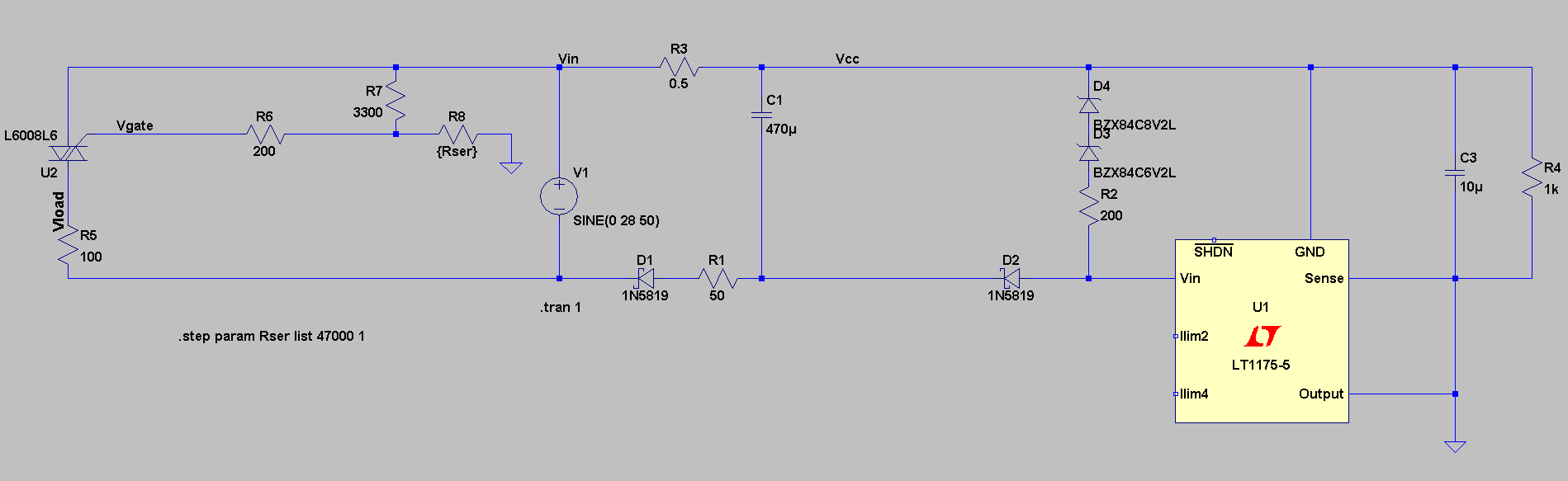

Here's a rough schematic. The 24VAC supply is regulated through a half wave rectifier and linear regulator to supply Vcc. I'm also planning on inserting a PTC on the 24VAC input for protection.
I thought of putting the current sense resistor on the low-side and then using a peak detector. Would that suffice? A hall-effect IC seems like overkill.
You have a fundamental flaw with how you propose to trigger the triac. Either you need a level shifter, a trigger transformer, or you need to put the triac on the low side of the load.

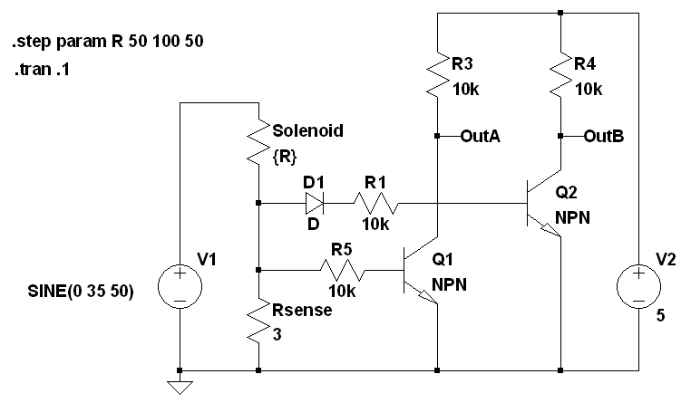

Great. Now you have me worried! Here is my spice circuit. It appears to work but am I missing something?
Here's one possibility:
OutA pulses low if the solenoid (load) is connected (current ~250mA). OutA and OutB both pulse low if the load resistance is < ~75Ω (current > ~400mA).
