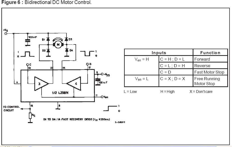

I'm using bi directional Dc motor circuit as attached here !
I'll download the LM298N spec sheet.
I would expect that +Vs would be at the motor volts of +9V and pins# 10/12
to be driven by logic +5V levels.
I will check this and get back to you.
EDIT: The datasheet says pins# 10/12 are TTL compatible inputs and the +9V should goto pin#4
Whether Flemmaed has a 9V supply or his post is for a 9V output from a 5V supply?
he may perhaps pick up 12V supply and regulate it to 9V by 7809 and any darlington like TIP transistor can drive the Fan with logic output.
Look at the datasheet for the L298 motor driver.
1) It has a 5v supply (VSS) for its logic and up to 46V supply (VS) for the motor.
2) It has an output voltage loss of 3.2V max with a 1A load and it increases to a loss of 4.9V max with a 2A load.
So you will need much more than 9V input for 9V output.

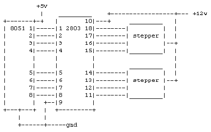

very simple sir...
Not only 9 volts but even 12 volts or above you can drive..
No need for getting into Difficult transistors or Op amps..
use ULN2803 or ULN2003 easily available in the markets.. at 20 rupees.. ( 50 cents ) ..
here's the circuit diagram.. in the thumbnails..
But, Sir one thing.. the output is sinking ( zero ) when the input is 1 to this IC..
Regards,
Simran..:)

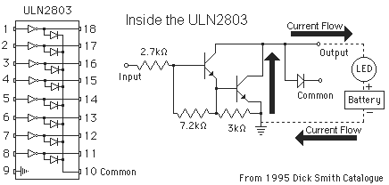

Simple to use..
This IC is simple to use..
it contains only DARLINGTON PAIRS that can be used for sinking of current at corresponding pin when the input is one at Left hand side..
In the right thumbnail.. you can see the internal structure of this IC..
Regards,
Simran..:)
hi simran,
The OP has an LM298N 'H bridge' driver which he wants to use as PWM and/or bi-directional motor driver.
The explanation of the UL series is interesting, but it does not help the original enquiry.

I have 5V output from my PIC.I need to run my 9v DC motor using that output.How do i do that?
According to your diagram and the data sheet for L298N, all you have to do is connect 9v to VS, 5v to Vss. Connect the motor as in your diagram. Connect pin 10 and 12 to the port pins of your PIC. And write codes to the port to switch port to 1 or 0 according to the truth table in your diagram. And that's it.
