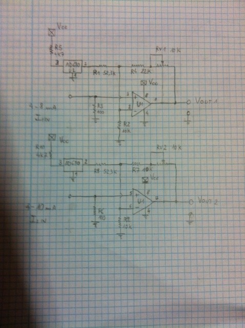

The monitoring system with LCD´s is already there, also analog to digital converters modules, I don´t have to change anything buying new modules. I´ve been repairing some of these modules, also adapting signals, I´m pretty sure the system installed on board was never working properly because of its configuration... I solved a lot of wrong things at this yacht.
Now, to finish the complete job I have to adapt this sensor signal, in this case 4 to 8 mA to a scale 0,4V to 2V used by the inputs of A/D converter modules. I usually repair and I don´t design a lot so I don´t remember very well when at school we calculated transistor circuits (Ib, Ic, Vce...).
My idea was to use a DC/DC to have a constant voltage, for example 5V, then a transistor circuit where changes the output voltage depending on the input at base (sensor signal), if necessary I can amplify the input with an operational amplifier which would drive the transistor, I can play with variable resistors to get the correct output scale, what do you think?

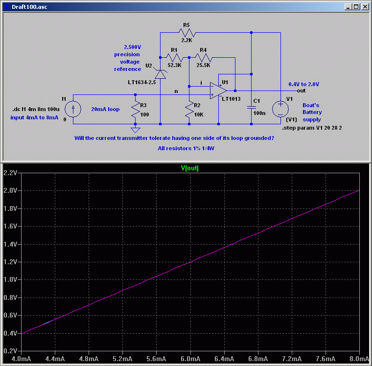

Try this circuit. The output is constant even though the boat's battery voltage varies from 22 to 28V. It puts out 0.4V with a loop current of 4mA. It puts out 2.00V with a loop current of 8mA. Change R4 to 14.0K for the 4mA to 10mA version. Note that this requires a precision voltage reference, and an opamp that will run from up to 40V which has a common-mode input range including ground....
Also notice the caveat about grounding one side of the loop.

R1-R2 could be replaced with a 50K pot. That would control the offset (move the purple line in the simulation up and down). R4 could be replaced with a 50K pot wired as a rheostat. That would control the slope of the purple line. Problem is that the two adjustments interact a bit, and it takes many iterations between the adjustments to hit the endpoints simultaneously. I would just go ahead and get the 1% standard value resistors...

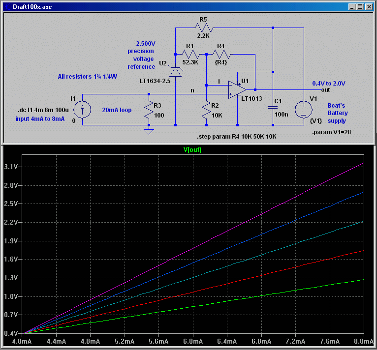

So if I need less output voltage, for example 1,5V instead of 2V, should I change value at R4?
OK, I have a Farnell account and I found all components.
Here is a series of plots of V(out) vs I(i1) at different values of R4, green is 10K and purple is 50K

One minor correction. Increase R5 to about 4.7K (value not critical). I just noticed that with a 28V supply, the current through the reference should be lowered from ~11mA to about 5mA.

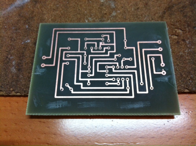

No, I still have to make it and put the board into a protecting box, thanks anyway for the advice.
No, I still have to make them and put the board into a protecting box, thanks anyway for the advice.

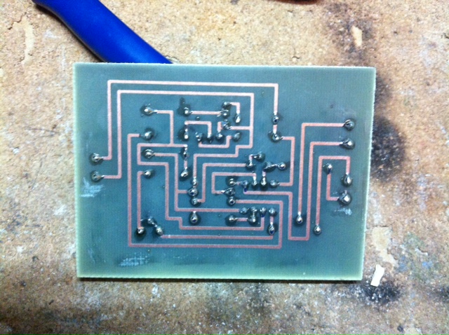

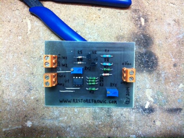

I´ve got a problem. When I finished the board I tested it at workshop before installing it on the yacht. I don´t know why the LT1013 exploted. I tested it again carefully and everything worked fine so I didn´t find out why the first time the LT1013 was damaged.
I installed the unit on the boat and final connection was power supply, again the IC was damaged. Now I´m waiting for new IC´s to replace it, I checked in the datasheet the maximum power supply is +22V and -22V so 22 or 28V is correct and accepted. I was thinking may be the problem is about having input before connecting the power supply because I don´t see any other reason, it shouldn´t be a problem but... When I receive new IC´s I can make the test, if that is the problem I can install a relays to detect first the power supply and then bypass the signals input. Do you think it has sense that the problem is because of having input before power supply ins connected?
