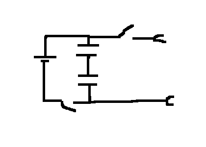

shock cartrige
do u think it would work

Where is the NO vote? this wont work
For a human to "feel" a shock it needs to be in the order of 100's if not thousnads of volts (a human can only feel a static discharge if it is greater then 1000V)
you are not going to get a battery with high enough potential.
Also the capacitance needs to be small otherwise you could kill.
As it stands the caps will not charge.

As your circuit stands, It won't work.
You would have to have an oscilator, transformer. rectifier, capacitors and know what amperage the discharge current is. Think dc/dc converter. I know it does'nt take much to kill someone with current. Be very careful.

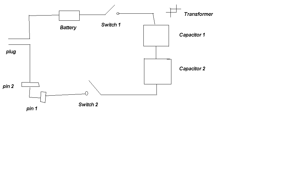

robotgangsta said:
could someone tell me if u think this will work it should charge the batteries and caps when i flip one switch and shock when i flip the other

your switches form an AND gate. In other words, nothing can happen until both switches are on.
