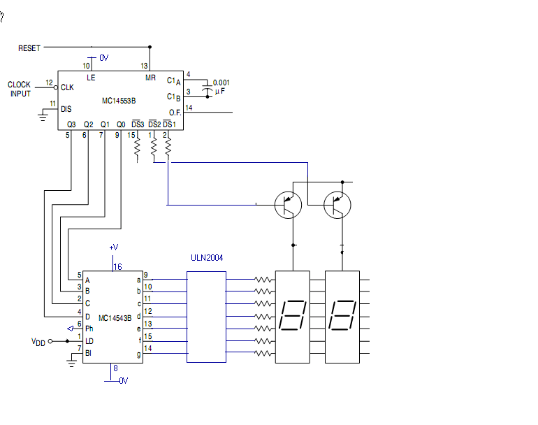

Greetings again; Thanks again. I have done as you suggested with the following results. When I power up the scoreboard the 2 digit led display flashes , however each segment of the display seems to flash at a different rate and at a different brightness. When I connect the test led to #9 on the 14553 pin it does flash. During this test, no buttons were pushed. Does this indicate that the schmitt is defective? Lorne
If I follow what you say.
Pin 9 switches hi/lo [ led on/off] this suggest the counter ic is working on that pin, which it must do if we are to get odd numbers.
Are the digits flashing about a 1Hz rate.? and do you ever see a '1' on either display..??
The different flash rate dosnt sound right.?
EDIT:
I cant see it on your dwg, but you do have a +V on pin 16 of the 4543 ic.??
EG All the led segments on the 2 digital display are flashing. Some segments are flashing so rapidly that they appear to be on while others flash at a slower rate. Some even seem to give a quick double flash.
Yes # 16 is to +V on the 4543. Also #1 is to +V on the 4543. Thanks for the quick response. Lorne
Are you sure you have a 1000pF [0.001] cap on the osc pins 3/4.
Ive cleaned up your dwg, added the ULN [ dont know what pins you use.]
You should be able to slow the 1 Hz pulser down by increasing the 10uF to say 47uF. for testing

Greetings The pins I use on the ULN are exactly as you show. Pin # 6 on the 4543 is also 0V. Yes I am sure that the cap is 0.001uf. Being a bit of a greenhorn I assume that 1 Hz is 1 pulse per second. By the way the test probe led on pin 9 does flash about 1 per second but all the display segments flash as I stated before. Lorne
hi Lorne.
As the fault is obscure, I would suggest the following.
1. Disconnect the two 10K resistors from the 4553 pins 1 and 2.
2. Connect the first transistor 10K directly to 0V [ so the LEFT transistor is always ON]
and the other 10K to +V [ so the RIGHT transistor is always OFF]
3. Disconnect the four wires to the 4543, pins 5,3,2,4
4. Connect the four pins of the 4543, pins 5,3,2,4 to 0V [ this makes the input = to a "0"]
5. Now switch on the power to the pcb.
6. The left LED should display a "0" [ the right LED should be OFF/blank]
Tell us what you see.
If it does display a "0" ok then
7. Disconnect 4543 pin 5 from 0V and connect to +V via a 10K resistor.
The LED should now display a "1"

OK Lorne.
Reconnect the two 10Ks back onto their pins of the 4553, so that they will drive the LED transistors as normal.
[Keep the the 4543 pins disconnected from the 4553.]
Repeat the 4543 pins 5,3,2,4 to 0V... the two LEDs should now both show "0"
if OK then
The LED' both should now display a "1"
Lets know..

hi Lorne,
Just one more check, hang in there.
I would fully test the 4543 in the following way.
You have done the "0" and "1" 's
If you now connect the 4543 pins 5,3,2,4 as follows, high/low you can check every number from "0 thru 9", if they check out it will prove the 4543 is OK and the problem maybe with the counter.
pin 5 high [with a 10K to +V]
pin 3 high [with a 10K to +V]
pin 2 low to 0V
pin 4 low to 0V
This should give a "3"
then:
pin 2 high [with a 10K to +V]
pin 4 low to 0V
This should give a "7"
If these test prove OK, then I would suspect the 4553 ic.

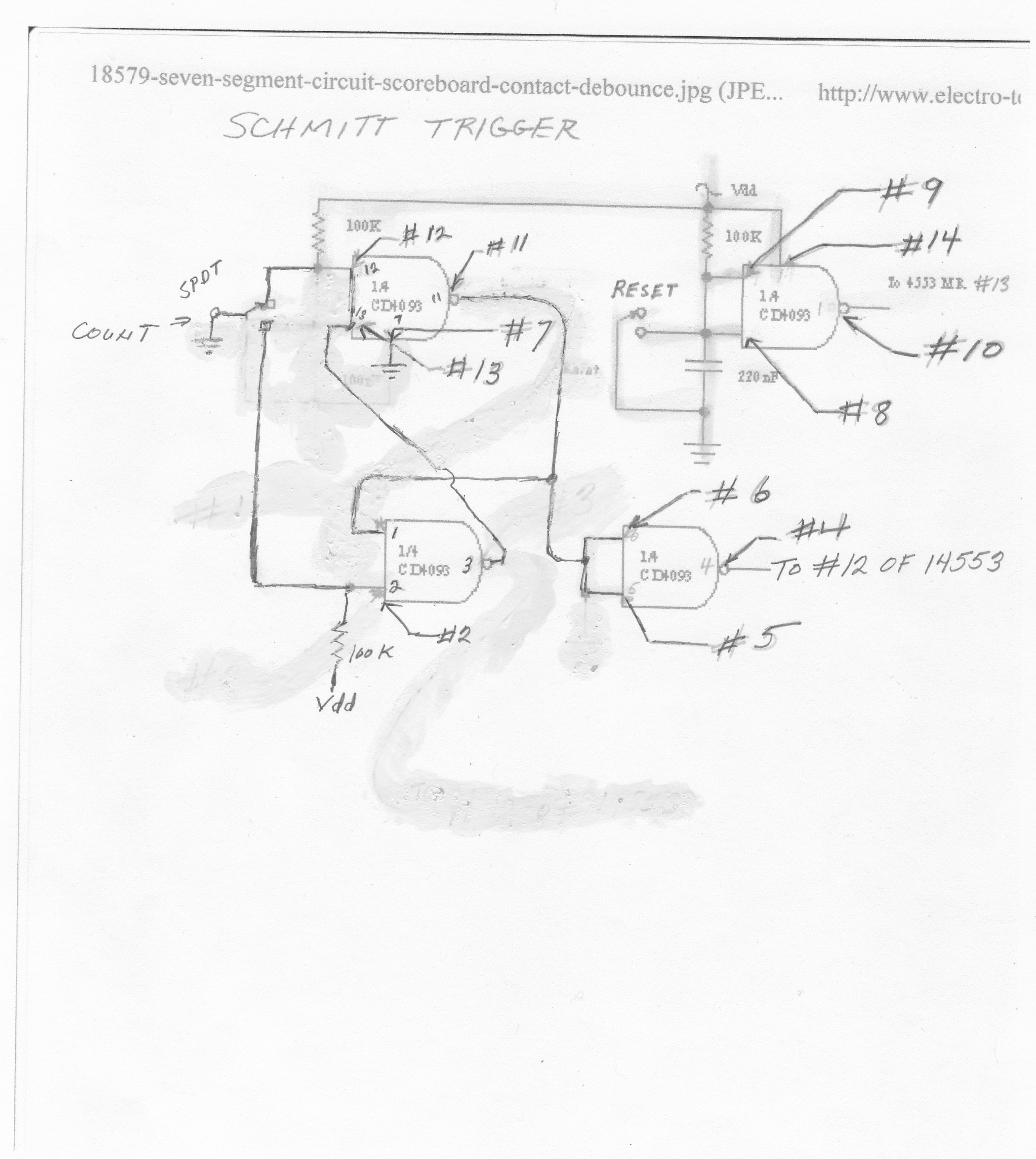

Hi Eric; Well I am back at the project again. The pins checked out ok on the 14543, so I installed a new 14553 IC and I still have the same problem. I have checked the capacitors "in the circuit" and they all seem to be ok. I have also checked the transistors "in the circuit" and they are ok. Is it ok to test these components in the circuit or should I take them out? The only difference that I see in the circuit from the first scoreboard that I made and this one is that the ground wire that I use for the common anode ground is a bit larger, but I didn't think this would make any difference. As I said before I have checked and double checked the circuit. Looking forward to hearing from you again. Lorne
seven segment led score board

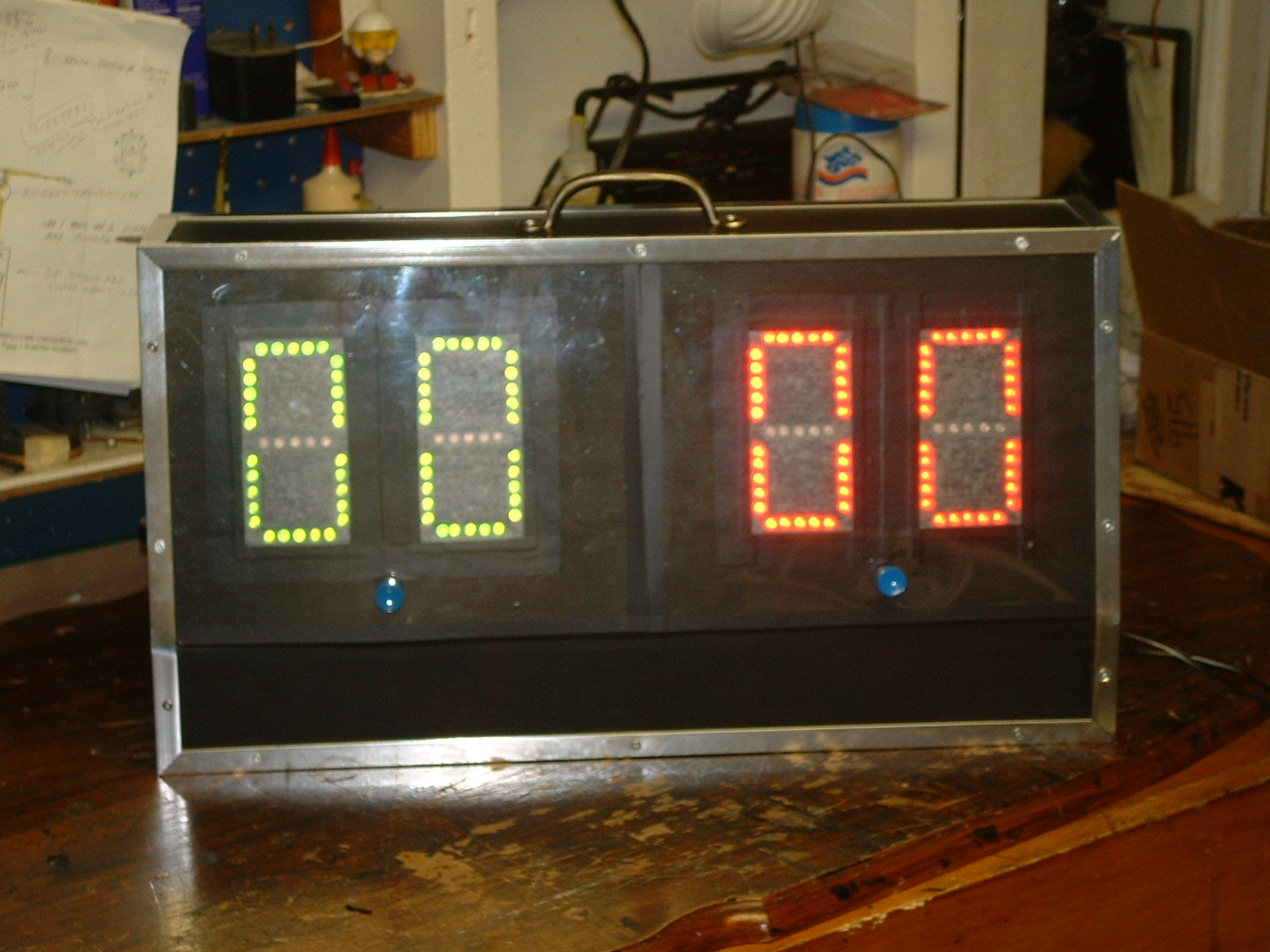

Score board update. Recently I found out that a friend of my son has had experience in electronics so I contacted him to pick his brains regarding the problem that I was having. He came up with the following modifications to the CD4093 Schmitt Trigger that I have attached below. Along with some wiring changes the counter switches were changed to SPDT. I did the changes and the scoreboard is now working as it should. Hope this is of some benefit to anyone that is interested in this project. I have also attached a picture of the finished scoreboard.
