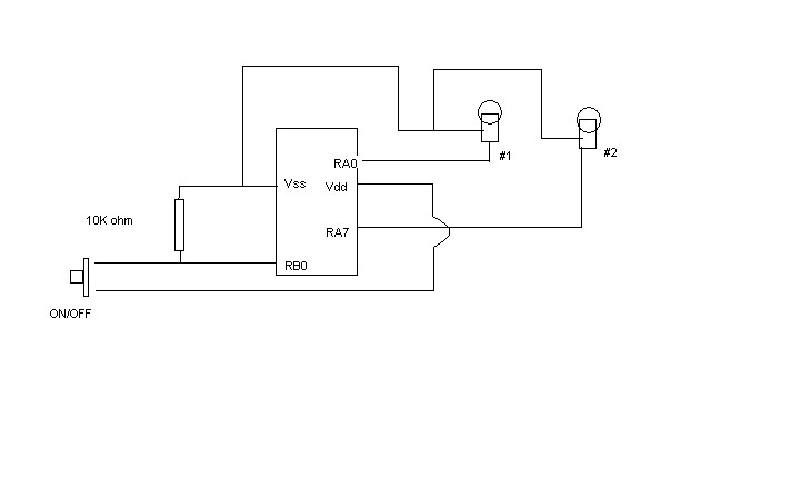

but, that is also not working I think something wrong with hardware, any way I have a spare16f628 and will try some simpler code on that, there is just one problem with 16f628 and that is it does'nt have any ANSEL register so how can I set the PORTS to work for digital ckt?
The 628 doesn't have an ADC module and so no ANSEL. It does have comparators and these have to be turned of by writing 0x07 to CMCON. You turn the WPUs on by just clearing bit 7 of the OPTION register and the int pin is RB0.
Here is the code for 628, pin 0 of port a will be HIGH and on interrupt pin 7 will also be high, running it in simmulation with F9 still hangs MPLAB and animation takes too much time, kindly check the code and tell me it is right or not then I'll move to hardware.

thanks a lot for all help!:)
I just noticed that your accessing Option_reg and WPUA in bank 2, they are in bank 1.
Edit, in reference to 690 code.
The RB0 interrupt is enabled by setting INTCON,4 not 3.
Edit, in reference to 628 code.
:)Thank you so much it works on hardware for 628 but only it responds to interuupt only one time. First when I turn on the power LED #1 lights up and then when I close the switch LED # 2 lights up (LED # 1 turns off), this happen even when I don't close the switch and just touch the RB0 side of the resistor lead, now again when I open the switch or remove my fingure from RB0 side of thr resistor lead LED # 1 should light up and LED # 2 should be turned off but this doen't happen, I tried resetting the INTCON,0x01 bit but, that did'nt work, though I think now I'm not too far.

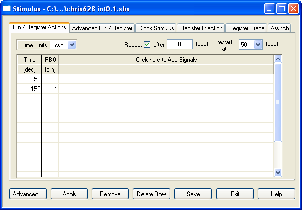

Your interrupt cannot end with goto inter. Try changing it to,

What I want to do is to light LED # 1 and when interr. occur LED # 1 turns off and LED # 2 lights up and these remains so until interr. presents, it did work with RB0 but not working with RB4-7. Please help me.
EDIT: IN CKT DIAGRAM IGNORE THAT IT RB0, TAKE IT AS RB4
