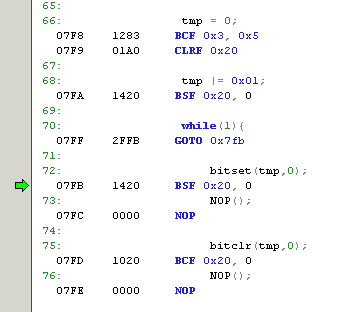

Brian Hoskins said:
But Mike's var |= 1 solution works fine actually.
Yes. If you look at the disassembly listing, you'll see that it's translated into a simple BSF instruction, as Mike said. Hi-Tech PICC compiler always checks if the mask is actually a 1-bit operation.
If you like to use bit numbers, you could use a simple macro, that will be translated into 1-cycle instructions (i.e. BCF or BSF):
unsigned char tmp;
#define bitset(var,bitno) (var|=1<<bitno)
#define bitclr(var,bitno) (var&=~(1<<bitno))
// test
    tmp = 0;
    tmp |= 0x01;
    while(1)
        bitset(tmp,0);
        NOP();
        bitclr(tmp,0);
        NOP();
