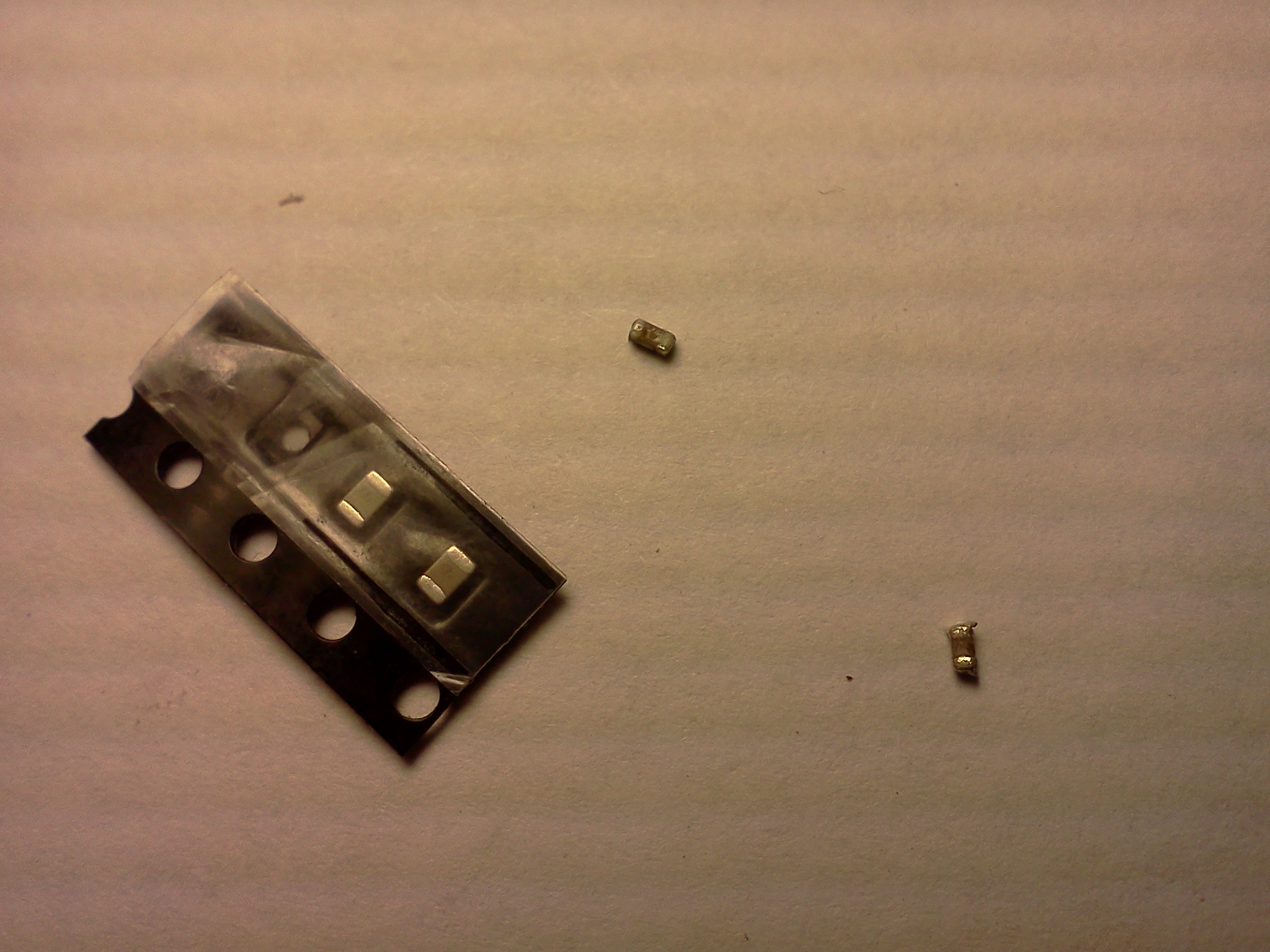

This is the best I can do for a photo of the capacitors.
The loose ones are the original parts taken from the transmitter, the 2 in the tape, are duplicates of the ones I replaced the originals with. Note the two empty capsules in the tape.
Hope this helps.
Note: I do realize the new ones are larger than the original parts, I ordered them with a 0805 footprint because I was told that that is the size I needed for the new parts. Perhaps the new ones are the wrong size? Or perhaps the manufacturer was wrong with their recommendation?

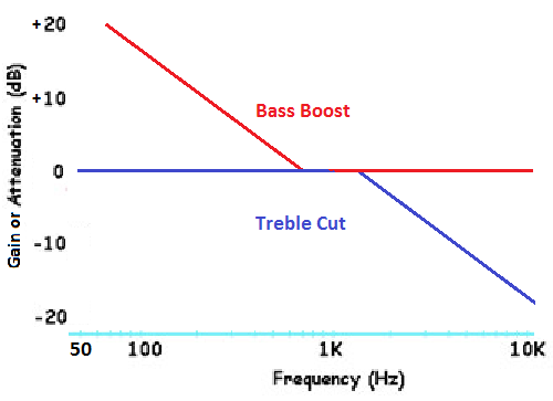

I think that bass boost sounds completely different to treble cut as shown on my graph:

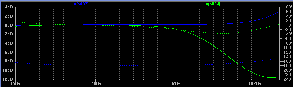

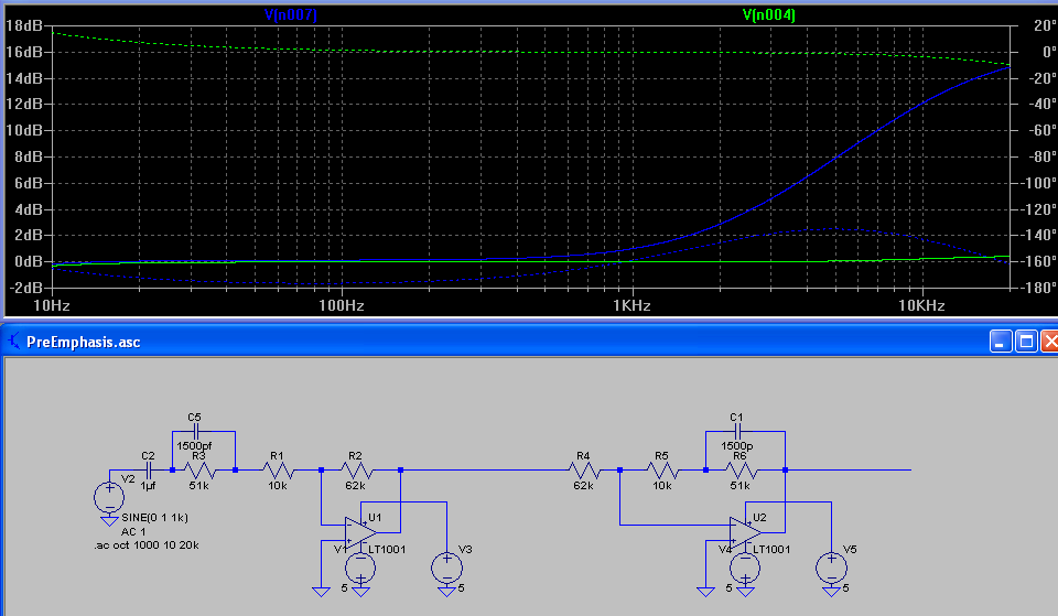

Here is a pre-emphasis (in the transmitter) and de-emphasis (in the receiver).
Blue = Pre-emphasis
Green = total.

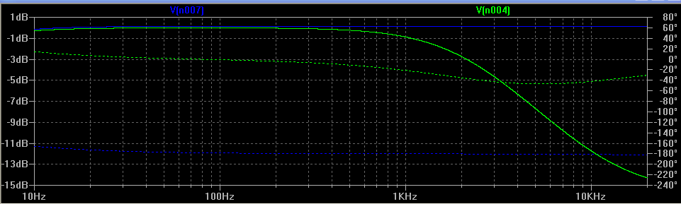

What would happen if the 1500pf was not in place. (0pf)
The high frequencies are almost gone.
Here is 1500pf was actually 150pf. Very little high frequencies.
-12dB to -14dB is not much cut but the lowpass filters in the IC reduce 15kHz about 3dB more for a total cut of -15dB to -18dB at 15kHz.
Actually -30dB produces little output and -60dB is non existant.
