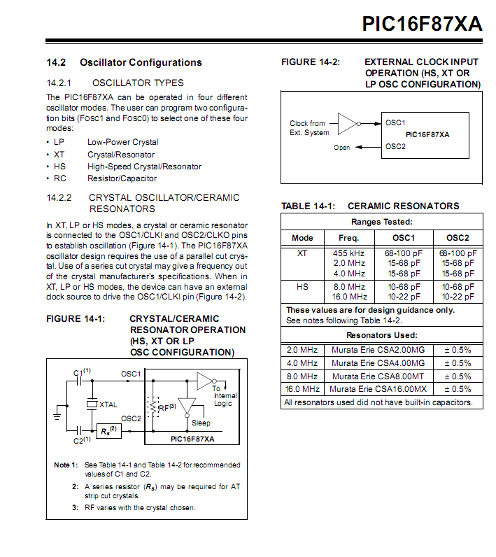

also ,
is 877A have internal clock ?
because i run out of crystal
No internal oscillator.

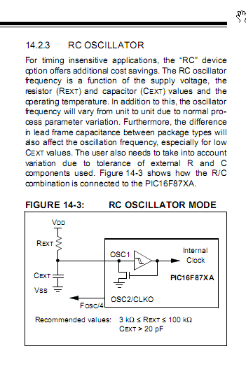

hi eric
what about if i using resistor for clock
as it shown on the attachment ?
You could do that, change that CONFIG to suit an RC osc.

Its just an output = Freq/4
so i need to set the the set clock to 4040000 , right ?
Unless you are doing something thats time critical, setting it at 4hHz would be ok, or as suggested change the PIC type.
