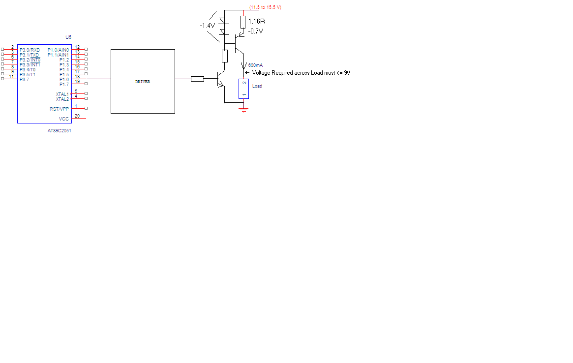

Refer the schematic below
My load is 600mA at 12 V supply. The FET is driven from a microcontroller. This MC doesn't have a PWM output. The solution came to my mind is:
1. Sense the current through the load.
2.Convert to binary and feed to the MC .(I think three bits are enough for my requirement)
3.MC will change the duty cycle to the driver input.
Request your comments and suggestions on how to implement.

Here also I think it is again like a series regulator .My load will take 600mA current if 12V is applied across it. So here the CC regulator will adjust the voltage in such a way as to keep the load current 600mA. Then
1.Min input has to be 14.5V (you indicated 2.5 V difference required between i/p and o/p)
2.If my input is 15.5, then 3.5 x 0.6 W will be dissipated by the regulator.
(In this case I have already made the LED lamps with series parallel combination with one series resistance with each branch. So a constant voltage is enough for me. If I remove the resistance and connect LEDs only, then the current sharing of branches-even if total current is 600mA- will not be same since my LED V/I characteristics may not be exact.
Again I may have to conclude that switching regulation alone will meet my requirements
For your comments please.

Just now I also replied to ericgibs in the same line. So you may pls look the diagram and remarks and give your comments on how to sense the current/voltage and generate 3 bit information for my MC
(In fact i have already completed the work and installed the unit in the site. But one mistake I did was I made an assumption that the DC from charge control unit is regulated 12V- communication gap between me and supplier. Now i have to work out a solution which can be added to that. That is why I planned the solution with minimum disturbance to the existing circuit.)
