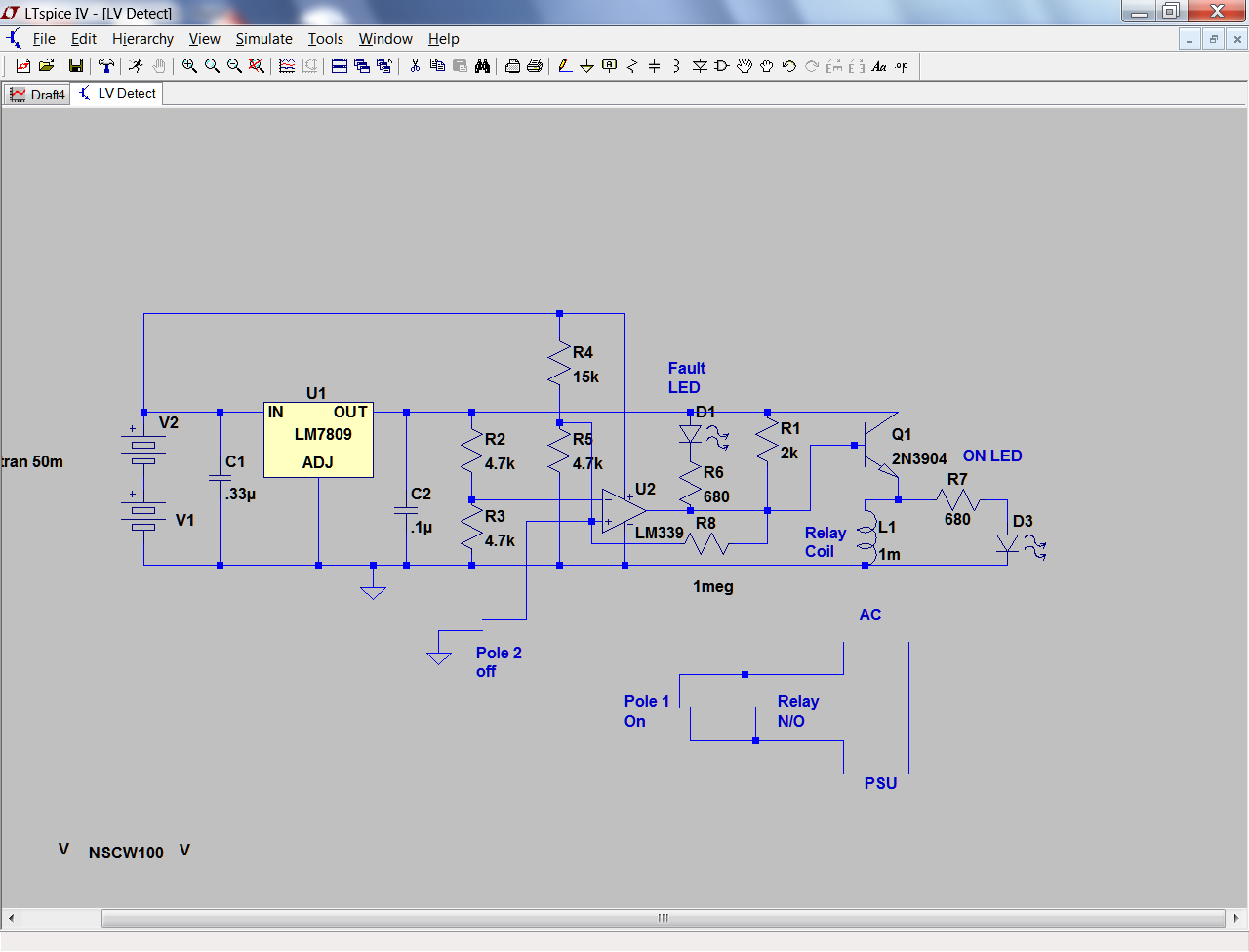

Here is one solution, although it got a little complicated. But it has the bells and whistles of fault indicator etc.
Here's how it works and a couple of questions?
This would replace your on off switch box for the 2 supplies. It has a momentary type rocker switch that in one direction turns on the ac to the supplies. So you press it and release it and the supplies turn on. If the combined voltage is over about 19 volts the relay turns on and keeps the ac going to the supplies when you release the switch and the green power on light is on. To turn it off in normal operation you push the switch in the opposite direction and it shuts off. If there is a fault and only one supply comes on when you push the switch to start they will power on but not stay on when the switch is released. While the switch is being held the red fault light will be on. If the supply fails in operation the red light will blink briefly and the supplies power down. It would be a pain to build 100's of these on a breadboard so if you go this way a little pcb might be in order though it will probably cost more than the rest of the parts. There is probably $6 in parts.
The 2 relay idea is simple. You could turn it on the same way, but I haven't found a switch type to turn it off. The diode is probably a good idea too, but it needs a pretty big heat sink or it will smoke.
Just to make sure. You still have 12 volts with one supply bad?
That's a pretty sweet design ronv...I like it. Especially at only $6 in parts. Of course there would be a little more than that for the enclosure box plug, wire, ect...but I am already paying for all those parts. I will have to look into the cost of getting it done up on a PCB. If it's not more than $5 a part (in bulk) it may be worth it in time savings alone.
Yes, if one fails then there is still 12v assuming one is still good, but then if two fail, well, then I guess I don't need to worry about shutting anything off anyway...so there will always be at least 12v.

Just dreamed about a possible problem - hate it when I do that. It takes a while for the voltage from the big supplies to decay after you turn them off, so it may turn itself back on after you push the off switch. Maybe you can check to see how long it takes for the voltage to drop with no load.
I haven't ever timed it, but I see it fade down every time I power down the dummy load...seems like about 3 to 4 seconds or so.
I was afraid of that. Oh, well there are 3 more comparators in the ic, maybe something easy will come to mind.

Granted I am as usual late to the party. Would this work? Take a 24 VDC coil relay like this type and power it off your 24 VDC. These relays have a drop out voltage rating of 30% so anytime your 24 VDC drops by 50% you can figure the relay will drop out. The contacts will handle the AC line to both supplies. Would something along those lines work? That is about as simple of a quick and dirty type solution that I can think of.
Ron
Ron:
Good point, Made me think of "voltage monitoring relays" https://www.google.com/url?sa=t&rct=j&q=&esrc=s&source=web&cd=1&ved=0CEAQFjAA&url=https://www.farnell.com/datasheets/1748204.pdf&ei=oNNFU9dB5s-wBKHygKAG&usg=AFQjCNFCPMbUfkH5IiqLhWk71RdqfWemNw&sig2=bN9D6vRcnz5_bmHwzGx5lw&bvm=bv.64507335,d.cWc&cad=rja
So, you either have to get the thing turned on or supply 24 VDC from an auxiliary supply for a short time during power up. Kinda like a diode OR or the aux supply and the system supply for a second or two during power up. You'd need to combine it with a delay on make time delay relay.
So, three off the shelf parts: A $20 AC-DC converter, REECOM RAC series, a time delay relay and a drop out relay and a diode OR circuit, Once the system powers up, the wire or gets broken.
This system allows auto-restart.
Suggested power supply: https://www.digikey.com/product-search/en?vendor=0&keywords= RAC03-24SCR/277
The TDR could be 24 VDC or 24 VAC. e.g. https://www.ebay.com/itm/24VDC-Powe...405?pt=LH_DefaultDomain_0&hash=item4176e70745 It's purpose is to drop out the fixed 24 VDC supply after say a few seconds. 6 min is a lot. Just meant to be a suggestion.
So, sequence goes like:
120 VAC is applied to RAC 24 VDC supply. A relay generates a 2 sec pulse on power up (AC or DC).
The voltage monitoring relay gets powered from the diode or of the RAC supply and the power supplies in series. After the 2 sec timeout, the or from the RAC supply gets broken.
To turn off, you just have to break the signal going to the voltage monitoring relay. A normally closed push button.
