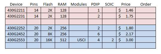

I'd like to find out what the limitations are for the free version. I'd hate to get into the situation where i needed 20 more bytes of code and had to shell out 200 bucks to get a better IDE.
The code size limits are described on the Launchpad wiki page;
Both IAR and CCS have free, code-limited versions, which are available for download. These IDEs will run full-featured on the available MSP430 Value Line devices, as these devices will not encounter the 4kB size limit of IAR, or the 16kB size limit of CCS.
That info' is a little outdated because there are several new Value Line devices available now with more than 4 kB flash memory. Here's a list of the MSP430 Value Line devices I've sampled so far;

There are also links on that wiki page to tutorials, forums, and a nice workshop, so it's definitely worth a careful read.
Cheerful regards, Mike

Haaa... exactly. That means now it has no limits, yeah? :D
