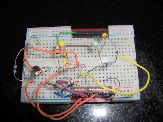

Did something similar, using some Arduino board stacking headers, proto board, and a medium breadboard. I think you can even buy a proto shield for the launchpad now.
