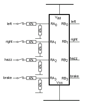

I am new to programming and am having trouble with a brake output staying on. I am using a pic16f88 chip. The turn signals and hazzards work correctly but when I use the brake it goes into keyscan and turns off the output. I am using the btfss instruction for all inputs. Any help would be appreciated

Well your code seems rather incomplete, missing subroutines like Loop2 and hazard etc so itas not really possible to establish what your real problem is.
Also your code layout leaves a lot to be desired, have a look for the 16F88TEMP.asm file in the Templates folder of MPASM , this give you a basic layout of all the essential things, particularly the CONFIG line for things like OSC and WatchDog etc
Have a go with that and see if that helps, also try using MPLABs SIMulator where you can software wise step though your code and actually see what is happenig, come on back if you are still stuck.
I haven't written the code for the brake output cause I can't get output to stay on. I want the turn signals and brake to work at the same time.
I haven't written the code for brake cause I don't know how
Ok - fair enough , you are lost on getting going with the code, its a common problem getting over that first hurdle.
Best thing is start at the begining with the proverbial led flasher or similar.
If you see the Beginners "Sticky" post at the top of this forum there is a list of Tutorials etc.
Your can do a lot worse than this one by Nigel who frequents this forum.
Here is what I have so far. But I don't know how to keep brake output on. I goes off when I send the code back to keyscan.
  • upload.asm
This code is quite inefficient there is only a super loop keyscan which CALLS a routine but there is no returns... if a call is made and the return is a mere 'goto' then the stack will fill up and no-one can keep tabs on it, there is no call to the brake routine or any variable to store the result in. Re-write all the routines to RETURN and a variable for left, right and brake. Then you can retrieve them in the loop.
Cheers Ian
So change all the goto commands at the end of each subroutine to return and create new keyscan loops for left,right and brake. And of course elininate the one super loop keyscan.
You are going to need the brake input on an interrupt as with this loop you can't get a uniform output when the indicators are on..

That why I said use interrupts... However thinking about this this is another candidate for a state machine.
Create an output buffer called "lights" and a time keeper, then cycle through the loop like so..
process turns ... set appropriate bits in buffer
process hazard ... set appropriate bits in buffer
process brake ... set appropriate bits in buffer
blit buffer to port
delay for visual
hey presto all the lights will correspond to the input signals
this way if you set left or right, hazard can overrule and it will look good
if you run two cycle keepers (timekeepers) you can delay the smallest time ie..(brake lights)
then double / treble the delay for the hazard / turn signals.
Cheers Ian
Someting like this..

The whole program can be done much simpler with a single routine.
Here is the start of the project with the circuit diagram:
Here is a sample .asm
  • CarTurnHazzardBrake.asm
The whole program can be simplified to this:
