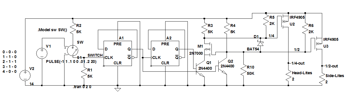

So just one more question Boncuk,the main problem I've been having with the electronic latches I've built so far (555s) is guaranteeing they always power up in their off state,I've cracked it now with a capacitor connected to ground and resistor to supply both on the reset pin.Is your design definately going to power up every time in the everything off state?
Chris.
Hi Chris,
there is no reason to worry about power up status of the "switches".
The debouncer circuit is forced low by R2 resulting in a H at the output of IC1A, inverted to L at the output of IC1B which feeds the clock input of IC2A. Set and Reset pins (IC2A and B) are tied to ground and there is no chance for the chip to change levels.
Level change occurs as soon as the momentary switch is closed, thus initiating switching sequence.
In that case IC1 takes care of power up reset.
Boncuk
Hi Chris, I think this is a simple design, no really sure, not really sure it will work, but it seems to work on spice. I used P FETs instead of relays also, but for got to add protective diodes as a just in case.
Any comments or corrections from others are welcome and it'll be a good circuit for all.
I can't draw you a circuit board design because I usually use perf boards.
Kinarfi
