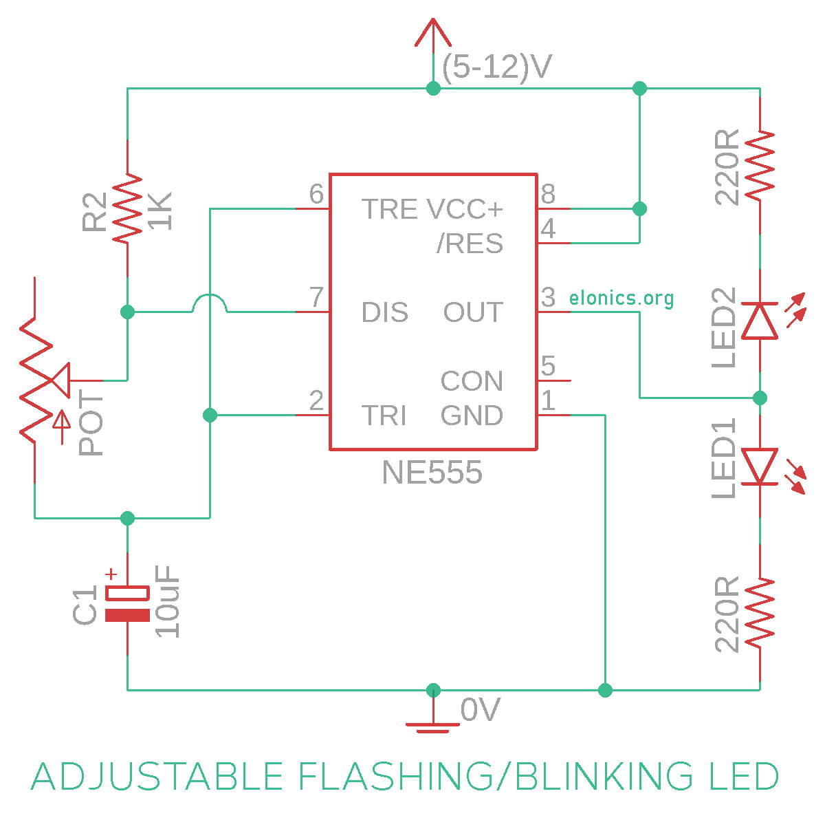

Does your truck's flasher lights look to flash equal time on/off?
I made the change, setting the pot to 100k and the circuit has improved.
with both inputs flashing the output flashes.

I will continue to check and compare my breadboard to yours and the schematic.
Thank you for the improved 555 circuit.
