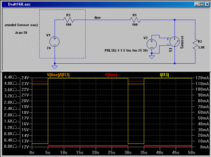

For example. An intrinsic sensor is a switch; either open or closed. The addition of R1 and R2 makes it possible to differentiate beweent a shorted line, an open line, and a proper indication of the sensor being open or closed.
Note line voltage V(line), the line current I(R3), or the line resistance V(line)/I(R3) on a good line. What would be the indications if the line was open or shorted?
Ok let's see. If the switch is open we'd have 22.8 volts at the switch (positive side) and if it is shorted we'd get zero volts and if the R2 resistor is damaged we'd get 24 volts.
Now here's a question. Assuming my answers were correct does that mean R3 and R1 would have to be more than 1.44 watt to account for the case of a shorted line?
You can base R3 on short circuit current. I=24/100 and P>(I^2)*100
and base R2 on I= (24/3.9K+100); assume the 100 ohm in the unit is there and the other 100 is missing. P > (I^2)*3900

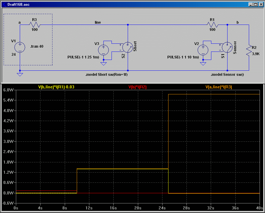

...Now here's a question. Assuming my answers were correct does that mean R3 and R1 would have to be more than 1.44 watt to account for the case of a shorted line?
Let's ask LTSpice: The sensor switches on at 10s, and the line is shorted to ground by the new switch I added at 25s. LTSpice knows how to compute and plot the power in any component, including R1, R2 and R3.
Note that I moved the power(R1) trace downward by subtracting 30mW from it just to make it visible.
