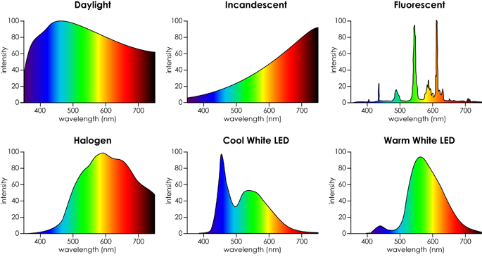

I also thought UV would be a key characteristic (assuming you don't have too many mercury-vapor lamps in your living room). If I am to believe these kinds of spectral response graphs, I still think it might but I would like to see them further into UVA (and even UVB, in case you are erasing EEPROMS [edit EPROMS]- j/k). Of course, when there are multiple light sources, it gets complicated. But, if the furthest UV portion (shortest wavelength) is only, or mostly, present in sunlight, you might be able to predict the intensity of sunlight and, thus, the contribution of sunlight to total illumination.
(from **broken link removed** and a lot of other places)
(from **broken link removed**)
This guy's patent attempts to do what is being discussed. The rationale for the "why" part is for energy conservation.
I also thought UV would be a key characteristic (assuming you don't have too many mercury-vapor lamps in your living room). If I am to believe these kinds of spectral response graphs, I still think it might but I would like to see them further into UVA (and even UVB, in case you are erasing EEPROMS - j/k). Of course, when there are multiple light sources, it gets complicated. But, if the furthest UV portion (shortest wavelength) is only, or mostly, present in sunlight, you might be able to predict the intensity of sunlight and, thus, the contribution of sunlight to total illumination.

The problem with UV is a lot of UV is blocked by windows and the fact that most UV photodiodes/sensors easily cost an upwards of $80 per component, especially for the low levels of UV you are trying to detect in these cases (sunlight outside counts as low level). There are a very couple of cheap ones, but not sure how well they work.
Yeah, that is an issue (UV blockage from windows). I did not think about that...
