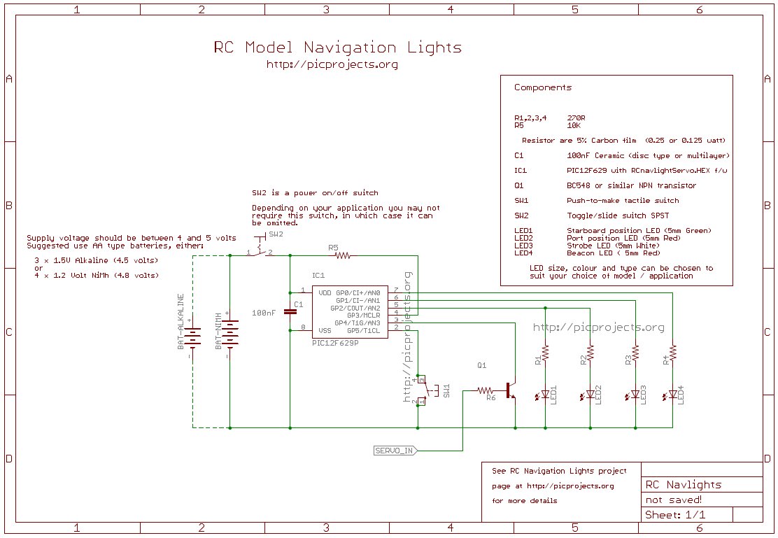

I suppose to put some context to this I was thinking of making this navigation/strobe/beacon LED controller for model aircraft.
If anyone has any other comments, advice or pitfalls I'd be interested to hear it.
I wouldn't have thought a simple LED flasher falls foul of any regulations?.
However, I would suggest you add an electrolytic across the supply rail - this would massively extend battery life.
