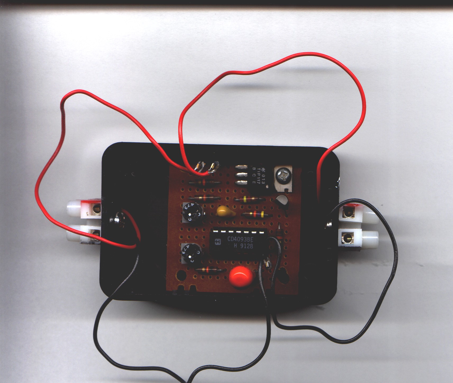

I do a lot of small one-off projects on these types of perf-boards: Dual Mini Board with 213 Holes - RadioShack.com Mount all the components on the other (non-copper) side with their leads through the holes. Solder the leads to the pads and trim off the excess. Do point-to-point wiring between the pads.
Ken

That's one way to do it.
I've never used the type of perfboard which has copper pads; I just use regular unclad board, stick the components in one side, then use my own perverted version of wire-wrap on the other side. I use telephone wire (small gauge solid insulated wire), wrap it around the component lead and solder it. I find I can make most connections without even using wire: simply wrapping one component lead around another.
This even works well with IC pins, provided you're careful soldering and don't let it get overheated. It's a little more work, but the results are neat and functional.
