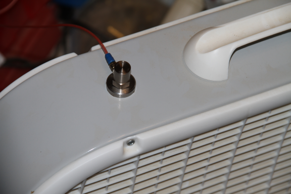

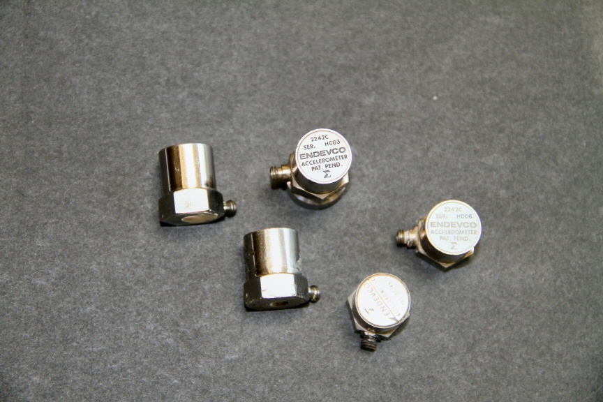

I got curious as to trucks on an overpass once and wondered what it looked like in my backyard. I used a single axis accelerometer which brings us to the type of sensor to use and equally important how sensitive is your sensor. I had a pile of old sensors so I tried a few ro see which gave the most bang for buck or actually pico coulomb/G or mVolt/G.
Hard to see but they are drilled and tapped for a 10-32 screw on the bottoms for mounting, I also had a magnetic base for them and the interfacing cable. Again, any wide range of sensors, including home brew will work, just make sure it is sensitive enough to pick up small shock and vibrations.
Next you want some form of data acquisition to get the data from your sensor and do something with it. You can display it but sometimes we may want to display and record the data. Chart it, write it to a data base, just do something with it. Here is a small example of where I was measuring a floor fan at different speeds.
