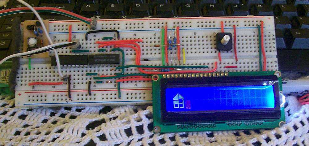

yay on the subject of lcds for this project. I finally understand custom characters :D but it sux that you only get eight lol. Im sure you could always redefine them anyway. But here is a picture. Sorry Bill ( William ( blueroom ) ) for copying the house. It was just a test. I had to zoom in on your image on the links page to count pixels lol. Wasnt too hard. This requires Futz "2 Wire LCD Code"
house-jpg.21139
My Function:
void def_custom(unsigned char bank,unsigned char r1,unsigned char r2,unsigned char r3,unsigned char r4,unsigned char r5,unsigned char r6,unsigned char r7,unsigned char r8)
        delay_ms(500);
        lcd_cmd(bank); //Bank starts at 0x40 (DECIMAL: 64)
        delay_us(160);
        lcd_char(r1);  // my custom char
        lcd_char(r2);
        lcd_char(r3);
        lcd_char(r4);
        lcd_char(r5);
        lcd_char(r6);
        lcd_char(r7);
        lcd_char(r8);
        delay_us(160);
	    lcd_cmd(0x02);
This is in my main to draw house
        def_custom(0x40,0x00,0x00,0x01,0x03,0x07,0x0f,0x1f,0x1f); //TOP LEFT
        def_custom(0x48,0x00,0x00,0x00,0x10,0x18,0x1c,0x1e,0x02); //TOP RIGHT
        def_custom(0x50,0x1f,0x1f,0x1f,0x11,0x11,0x11,0x1f,0x00); //BOTTOM LEFT
        def_custom(0x58,0x02,0x02,0x1e,0x02,0x02,0x02,0x1e,0x00); //BOTTOM RIGHT
        delay_ms(1000);
        lcd_line1();
        lcd_char(0x00);
        lcd_char(0x01);
        delay_ms(1000);
        lcd_line2();
        lcd_char(0x02);
        lcd_char(0x03);
