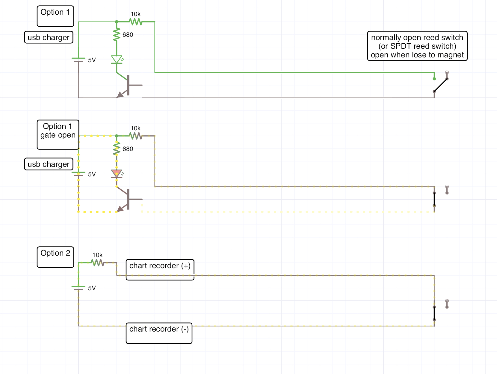

Hi I am a newbie with limited electronics knowledge (built valve radios and transistor stuff as kid in 60's) I have a gate about 60m from my house and i never know if it is left open or shut. I am seeking to build as cheaply and descretely as possible a device that will indicate whether the gate is open or shut, i would rig this to a pen chart recorder to record time of opening /shutting (built from a 24hr clock and solenoid stylus. I thought to use a 433mhz key fob transmitter and solenoid receiver ala ebay and as the gate is metal with plastic coated netting over it i thought to use the gate itself with the slide bolt as the contact switch. so by running the power from the key fob switch through the gate circuit i could get a continous signal when the gate was closed with the latch slid into the gallvanised metal keep. I realise this will use up a lot of power and wireless transmission so ask for suggestions as to how electomechanically i could generate a pulse on for close , then when the circuit is broken another pulse for off. Would be grateful if anyone could make some suggestions as to the simplest way of achieving this?

The 60m is big distance for 433MHz transmitter. Also, without some type of encryption, you'll be getting pulses all day long caused by noise.
I would recommend a hard wired pair going to the gate. A magnet on the gate latch and a reed switch mounted next to the magnet.

Could someone suggest a simple wireless solution? The gate sender needs to be battery operated.
The Tx/Rx systems used for RC model control have a range >>50m. Might be the basis for your project?
The TX accepts potentiometer and switch inputs, so would be simple to interface to the gate. Battery power consumption could be kept to a minimum by having a timer to switch the Tx on only occasionally.

I think would go with linear/Nortek DXS series transmitters/receivers. e.g. https://www.nortekcontrol.com/produ...less/dxsr-1504-supervised-4-channel-receiver/ You need a power supply too. I mounted everything on a DIN rail. receiver, power supply, relay modules, and Buzzer/"glue logic".
They make a specific door/window transmitter https://www.nortekcontrol.com/produ...-supervised-universal-doorwindow-transmitter/ You might have to weather proof it bit. Here https://www.polycase.com/product-categories is a place to start for a case. If you already have a battery out there an LT3045 based regulator could work:, https://www.aliexpress.com/item/400...earchweb0_0,searchweb201602_,searchweb201603_
It won't be "super cheap". They have a low battery and supervision as well. Supervision can be enabled/disabled. These are used for alarm systems. I have a PERS (Medical alarm) based on their technology.
