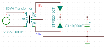

yes (e.g. input 220VAC and secondary 36VAC center tapped)
will STPS2045CT works for this type of transformer?
If you use it as a full-wave rectifier with the transformer center-tap grounded, and you current is less then 10A, it should work fine. But for this application it has little advantage over a standard junction silicon rectifier.
is this right?

That looks correct.
does it mean you're not so sure? :) :confused:
It means the basic circuit is correct as drawn, but it's actual performance depends upon your application. For example, if you draw the full 85VA from the output or over 4A, then the ripple will be over 4V with the capacitor filter value you show. I don't know if that would be acceptable for your requirements.
do i need to replace the caps with higher capacitance like 20k uF or get a smaller one?

Ripple goes down as capacitance goes up. Doubling the capacitance will cut the ripple approximately in half.
