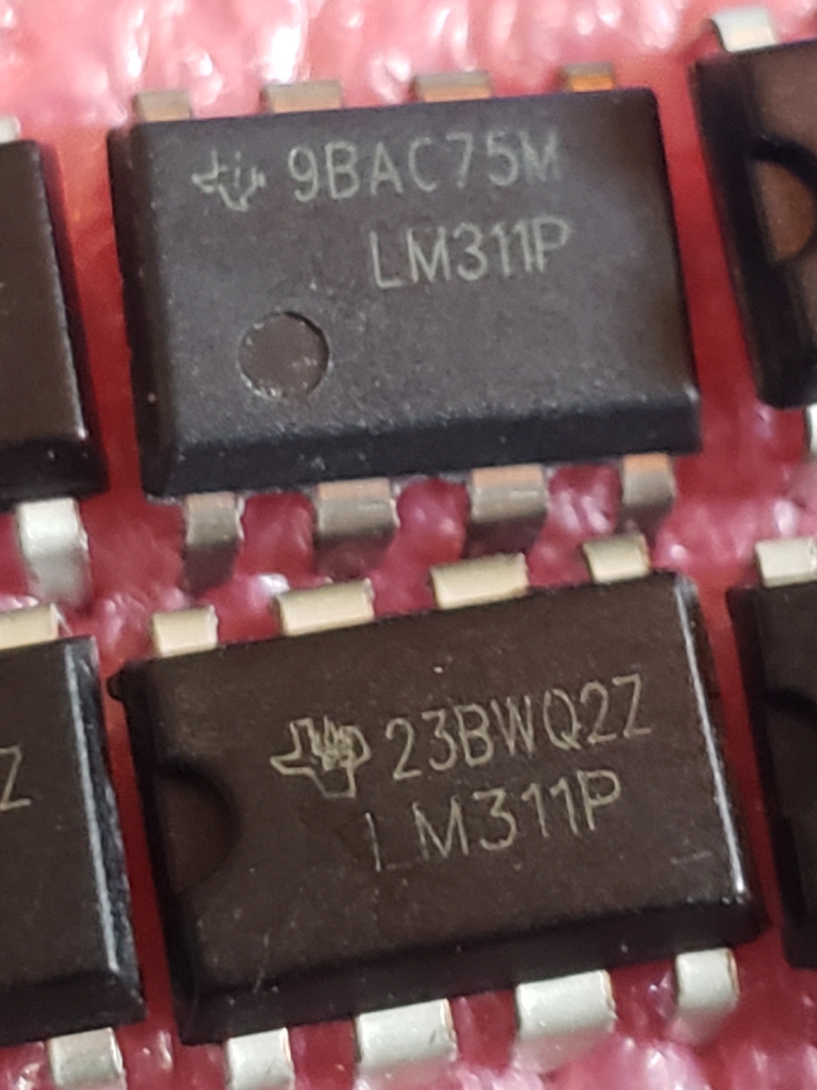

Thank you. I completed a PCB. It did not work at first so i did the easy thing and replaced the IC with one from a different batch. That fixed it, HOWEVER... I decided to check another from the 1st batch and that also did not work. Swapped it back with the previous and WTH! that IC no longer worked. So I had one more IC from the 2nd batch and its running now but what happened?
When I say did not work:
When powered up it engaged the relay. adjustments , light, dark had no effect on the circuit.
Top IC is from my older batch
Those IC's look suspiciously different?, depending where you got them either (or both) could be fakes - various dodgy Chinese companies relabel any old faulty chips they can get and sell them on as completely different chips.
The top one in particular looks like it may have been sanded off, and reprinted.

That bottom IC logo doesnt even look like Texas. This is the first and probably last time i will buy a component from ALIExpress. Your not gonna believe how the seller sent me the parts. And yes, thats STATIC CLING WRAP.
