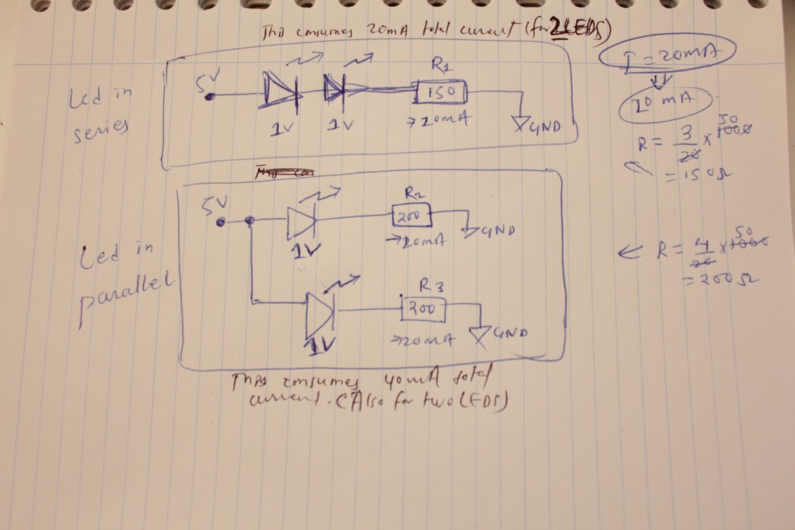

Hi I have the LEDs set up in circuit as follows: Very simple series and parallel. Now what I assumed is that the LEDs need 20mA current to give max light.
My question is .....if they are in series the two leds consume same current to give maximum brightness....if they are in parallel the two leds consume twice as much the current in series....so my analogy is that the battery lasts for longer time in series LEDs but the amount of brightness..for both the circuit is the same...pleas throw me some light if I am missing something..

Okey, I am sorry but I am still a bit confused. Here is my calculation.(and yes in reality the voltage drop across the LED is more than 1. I just assumed for the sake of simplicity of calculation)
I assume the 5V power supply in both cases
When the LEDs are in series:
Vin=5V
Vled=2 X1[V]=2[V]
Vresistor=3[V]
Current=20[mA]
R=(3/20)*1000=150[ohm]
Now, Power consumed by LEDs= 20 *2 = 40[mW]
Power consumed by resistor = 3 * 20[mA]=60[mW]
Total power consumed in series = 100[mW]
When the leds are connected in parallel:
Vin=5V
Vled_1=1[V] , Vled_2=1[V] ,
Vresistor_1=4[V] , Vresistor_2=4[V]
Current=20[mA] each
R=(4/20)*1000=200[ohm]
Now, Power consumed by LED_1= 20 *1 = 20[mW]
Power consumed by resistor_1 = 4 * 20[mA]=80[mW]
Now, Power consumed by LED_2= 20 *1 = 20[mW]
Power consumed by resistor_2 = 4 * 20[mA]=80[mW]
Total power consumed in parallel (for same amount of light) = 200[mW]
I just want to know if my assumption is correct or not. Uncle scrooge made it quite clear about the life time of the battery but he didnot say direct yes to my question. I want the answer YES or NO please. Till now I rely on uncle scroog's explanation and assume that he supports my arguement. have nice weekends

What 'hypothesis'? - it's standard technique to place LED's in series, you get less loss from a higher supply voltage (essentially because there's only one series resistor, instead of a separate one for each LED in parallel). In either case the actual design depends on the number and type of LED's and the supply voltage available - essentially LED's are current driven, and a constant current source is the best method of feeding them (and again, LED's in series are best for that).

As with many (most?) 'problems' the correct application of ohms law clears everything up.
If you use a power supply that holds up its voltage pretty well then when you connect the LEDs in series the total power used is low.
But if a battery is used then the LEDs soon turn off as the battery voltage drops.
If you use a battery that drops its voltage as it runs down then connect each LED with its own current-limiting resistor so that the LEDs continue to produce light as the battery voltage runs down.
Your math is correct.
