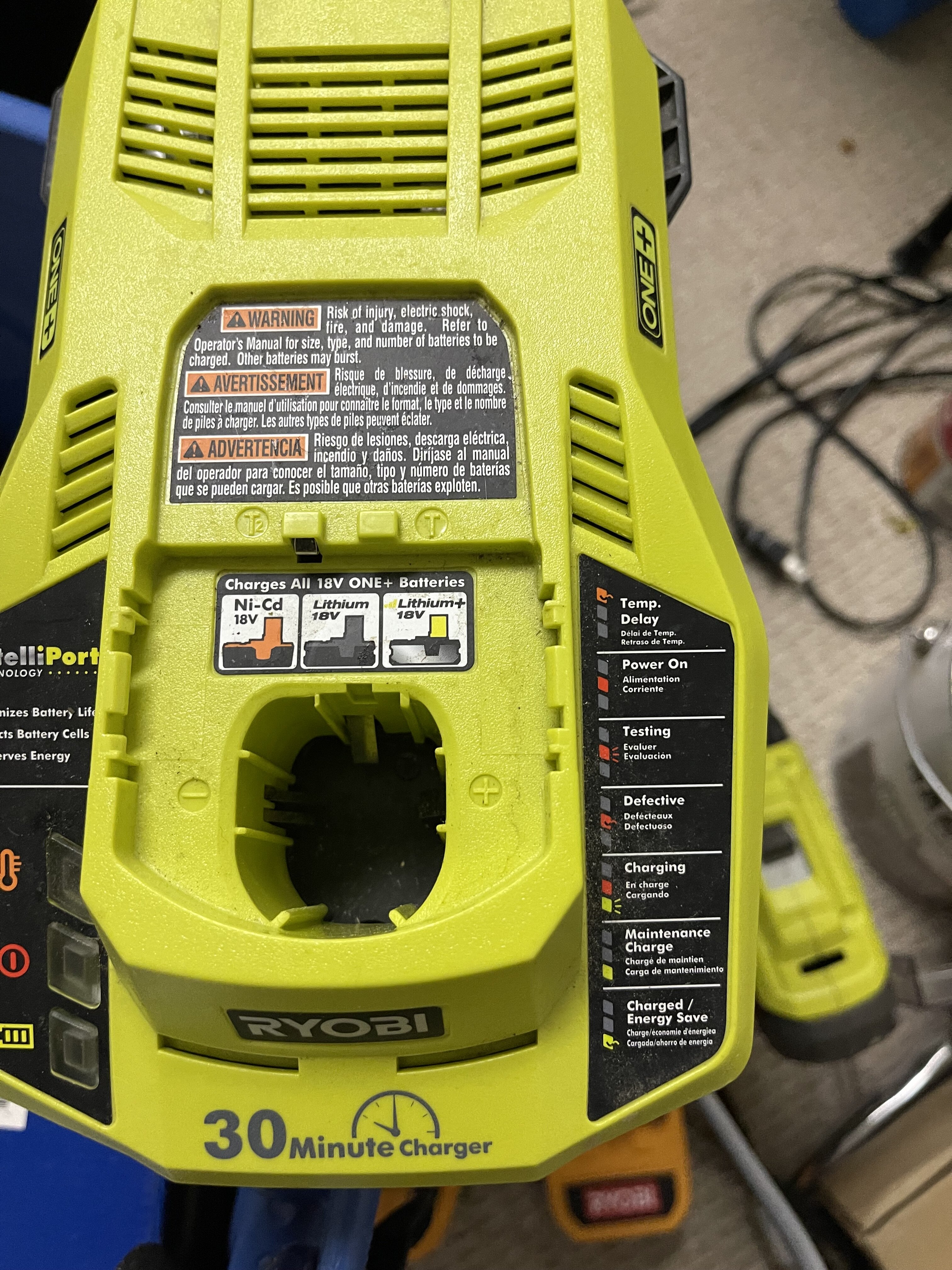

Yeah, it's relatively easy to figure out what type of battery you're charging, and alter the algorithm accordingly - yet another reason to use a micro-controller in them. Nice that it clearly labels what the LED's show - often it's only explained in the instructions, which you never see again
