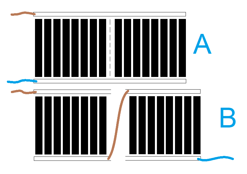

So basically where the strip is supplied by the foot (cut lines for guidance) and a 2 foot length would normally be wired as per A an the attached diagram when used with 110v, If I wired them as per diagram B and run them from 220v / 240c UK mains there would be no issues other than taking longer for the mat(s) to warm up to reach the set temperature of the thermostat

No issues at all, and each section will be operating at the design power level and take exactly as long as it's supposed to to reach temperature.
Make the length of each piece as equal as possible.

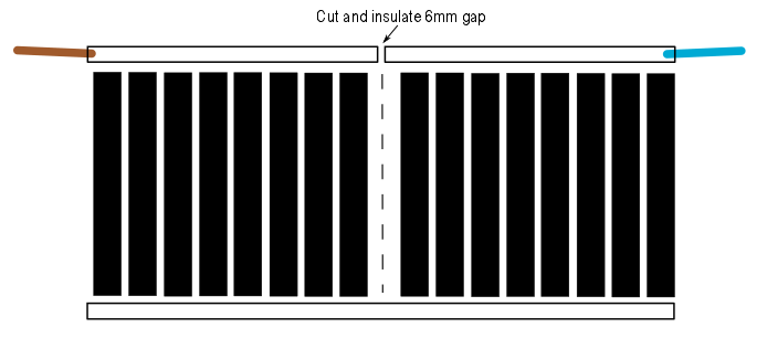

If you're using it as a 2 foot section, this might be easier.
