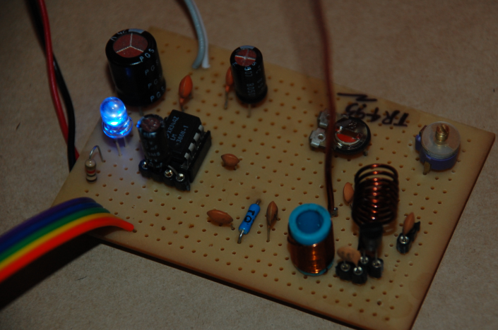

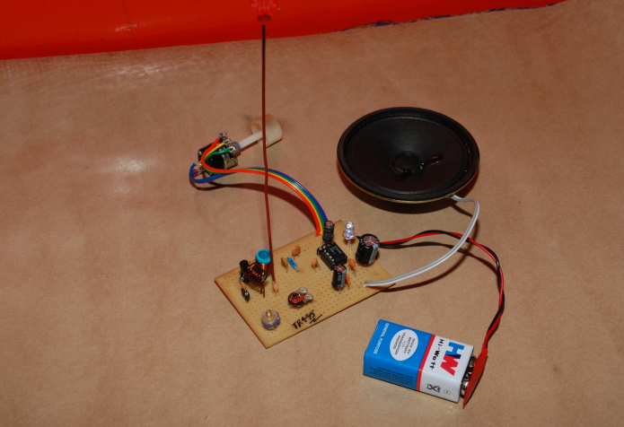

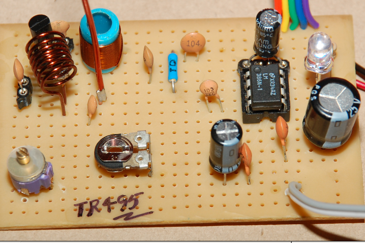

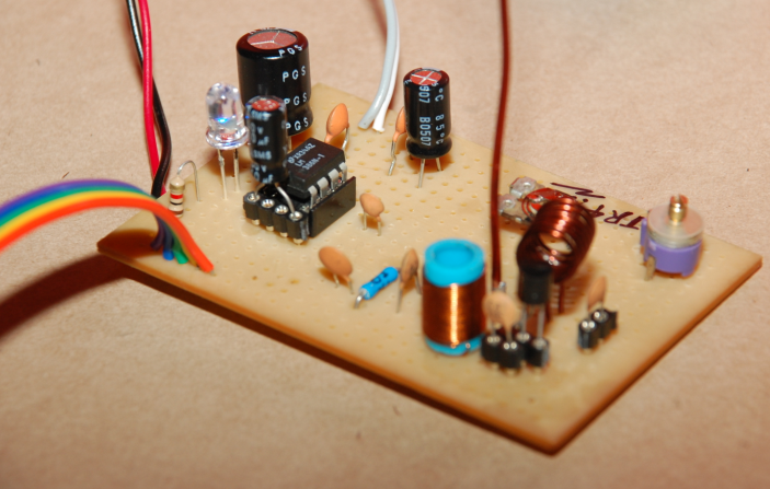

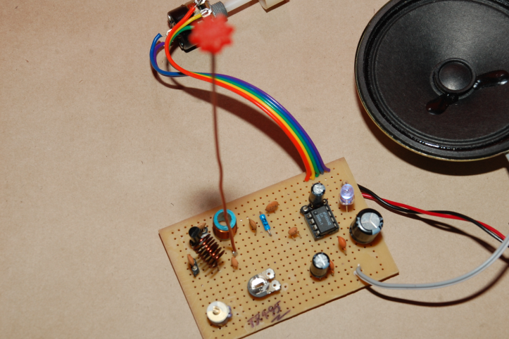

Hi Guys,
Snapshots of my regen wizard. Enjoy :p
I think I've done it pretty neatly. But not much satisfied on the layout. I was excited so much and done the planning and assembly within one day.
Still I'm searching for a good quality tuning cap in place of the dirty trimmer which is making frequency drifts while attempting to tune using a metal tool.
Anyway the 50pf trimmer clearly covers the entire fm band .

Hi Guys,
Hi BC,
An old plastic knitting needle filed down, makes a nice trimmer,
Raid your girl friends knitting box...:)
A little thing you may not be aware of, the adjustment slot on the trimmer is connected to one set of vanes, that set of vanes should be connected to the 0volt line in order to minimise interaction when adjusting the trimmer.
Otherwise when you touch the trimmer, you will be adding capacitance to the tuned circuit.
See my edited version of one of your pictures.
The instuctions for the project say to buy a cheap little radio and use its tuning capacitor and knob.
Hey Eric, that's a good idea! :D
Thanks Jimb for ur suggestion. Anyway I'll find out an fm gang cap soon. I've left required space around the trimmer.
Guruji,
I'll give 10% distortion for the audio. The most distorted files in my recording are not properly tuned stations. Because I'm using the coil stretching method. After tuning it'll return back a little bit.
Yesterday I've connected a good quality Hi-Fi headphone and I got extreme bass and treble. Truly unbelievable!
It has plenty of volume when I put the speaker inside an enclosure. Also more realistic sound.
I've a plan to make it modify for AM band.
Also I'm planning to add a single stage BC549 and to replace the LM386 with my TA7368P amp(more power!) :p. That should give a more decent performance. A pretty neat construction inside an enclosure .Not exactly now.

Yea, I bought one fm only tunig capacitor. Just glued it on to the board in place of trimmer and the trimmer kicked away. Attached a plastic knob and now everything looks marvellous. I can tune in stations easily and no frequency drifts. :)
The tuning gang capacitor was very cheap. Only Rs: 8 :D
But the combined AM/FM big gang cap costs Rs: 50!
