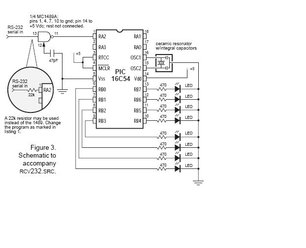

Id like to use pic to control a stepper motor. The input commands of the PIC should come through the RS-232 serial port. Ive seen the attached schematic online but I can't see where is the RS-232 input to the pic micro-controller... Can u help me plz? and if anyone has any relevant schematic diagram? your help is deeply appreciated

The schematic you posted does not show a PIC microcontroller...
Do you have a particular PIC in mind?

Please forgive me... I missed that...

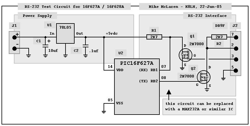

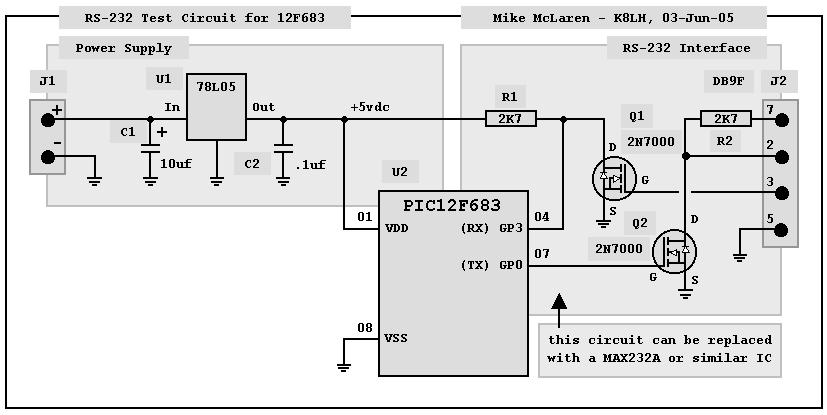

It seems pin 4 is being used to receive RS232 data... I've done this on 8 pin 12F675 and 12F683 devices utilizing bit-banged serial code but I used 2N7000 (BS170) N-channel MOSFETs for the interface...
Regards, Mike

I'd hold out for the 628 as that has an async port, bitbang serial I/O is a bit of a pain, especially to debug. You'd only need the RX side of mike's circuits, by the way since your diagram did not show TX in use.
Does the original design look ok for you guys? It appears to be less compicated.... I can implement it on PIC16F628 or PIC16F84, TRUE?
Bit banging serial is dead easy on a PIC, and not a pain at all, hardly any more complicated than using the USART.
HOWEVER! - it's still worth using the 16F628 and USART, as it means you don't waste processor cycles bit-banging the serial routines.
I've never got around to completing my stepper PIC tutorial yet (so much to do and so little time!), but essentially I used timer interrupts to do the stepping (with tables for the step patterns), and using a switch on an I/O pin to select half or full step modes. I did implement a bit-banged serial port though, and controlled it through that - although, as I said previously, using the USART in the 628 would be advantageous (my code was based on some old 16C84 code I wrote years ago - before the 628, or even the F84).
You should be aware though that the USART requires inverted data, so you need to use a MAX232, or similar interface, that inverts the data.

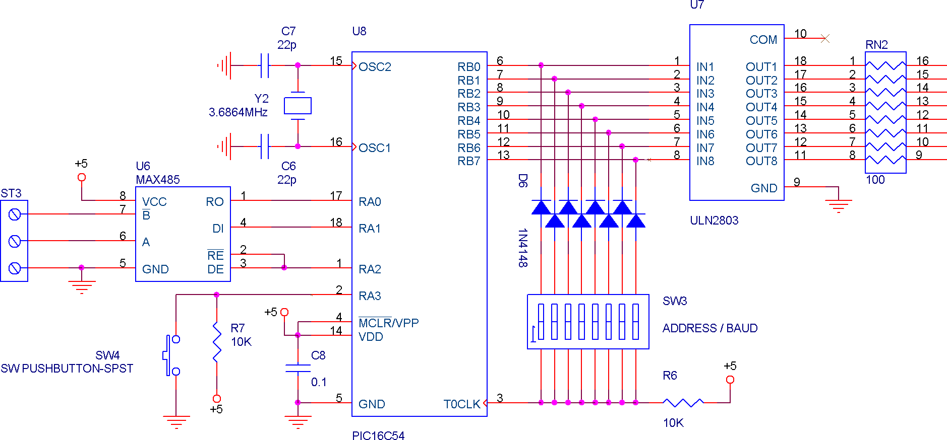

Ive found the PIC application notes really helpful so 2sum up I can use the attached diagram with the PIC outputs being connected to the ULN 2803 instead of being connected to the LEDS? YES OR NO?

perpetual_dream said:
OK.... THANK U ALL GUYS....
THANKS AGAIN FOR YOU ALL... U R BY BY FAR THE BEST HELPING FORUM ONLINE
Yes you could, however you should be aware that the diagram you posted is a serious antique - in car terms it's not a model-T Ford, more a horse and cart!.
Check my tutorials for far more modern diagrams.

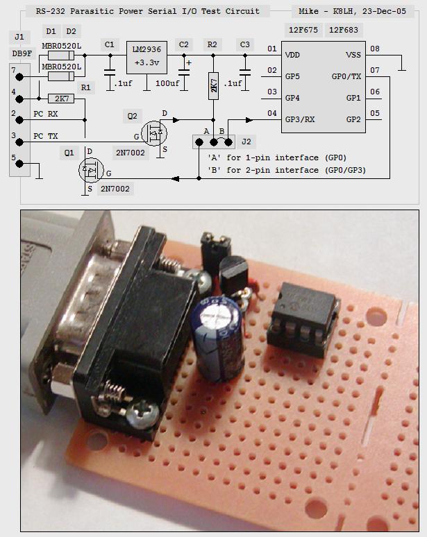

Not to worry... Should you ever find yourself in a position where a little 8-pin 12F675 or 12F683 would fit the bill and you need reliable bit-banged half-duplex or full-duplex serial I/O, with 16 byte circular Rx and Tx buffers no less, please don't hesitate to ask... You can also do half-duplex I/O using a single pin...
Kind regards, Mike
