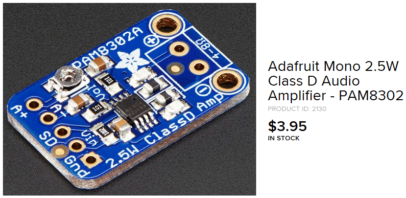

People are buying an American class-D bridged amplifier IC on a pcb that produces 1.3W into 8 ohms with fairly low distortion when powered from 5V (2.5W with high distortion into 4 ohms). Look at the datasheet for the PAM8302A. The assembled amplifier is available cheaply from Adafruit, Aliexpress, ebay and Amazon and is here:
