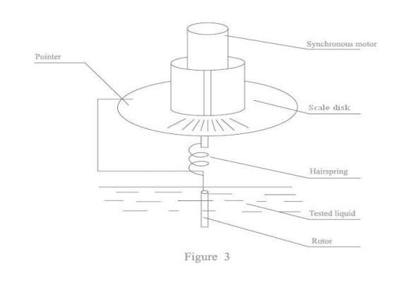

I have to build a viscometer that measures viscosity . It will have to be a rotational viscometer..
I tried using the torque of a DC motor but unfortunately measuring torque of DC motor is very difficult. But only with some expensive torque sensor (~1000$) possible. But we are looking a cheap solution or any other method.
Any ideas about how to make...

I think you need feedback to keep the motor constant. Measure the current in air, then in solution. Current2-current1 will have a function that gives viscosity.
Why the big money for measuring torque? Torque can be measured on the motor shaft, or the motor body or the container.
To measure torque you could have a pivot bar that's rotated by the motor and presses against a load cell. You can get the load cells very cheaply from banggood. They range from 1kg to 50kg.
By looking at other rotational viscometers: some use a synchronous motor held constant speed by the power line. The solution container wants to turn. A simple coil spring keeps the container from turning too far. Watching how far the spring turns.
In this picture the spring in on the motor shaft but it could be in other places.
I like Mike's idea of load cell. You should be able to measure torque at the motor or the container.

It consisted of a geared induction motor, probably 3-phase, turning a flat disc in the slurry being measured. There were small, curved, radial ridges on the flat disk. The disc would have been at near constant speed. The torque was measured by measuring the reaction force on the motor.
It seems that measuring the reaction torque on the motor is the easy way to go.
For a prototype you could use an arduino with pwm controlling the motor, feedback from it to maintain a constans speed, then a bearing such as a vcr player head for the sample jar to stand on, then a load cell and something like a Hx711 load cell amplifier to i2c to measure the rotation force of the sampl jar,

Or do the same but have the load cell measure how much the motor moves. That way everything is in the head unit.
Measuring motor current works but as the motor ages it will need calibrated. The load cell does not have old age problems.
