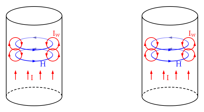

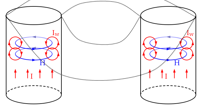

In transformers, the current can flow one way on the outside of the copper and the current seems to flow backwards in the center of the wire. This really increases the heating. With current flowing upward on the outside, the little red circles spin pushing current back down the center.
Wire above, cross section of water pipe below.

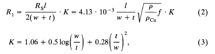

As long as there are no other conductors very close to the strip, current flows on both sides - you use 6". The current will not be uniformly distributed across the surface, you get significant crowding at the edges - this increases the loss. If you are trying to calculate the effective resistance, look here
see eqn 2 and 3
which give the resistance/l, where K (>1) is the factor that accounts for the current crowding.
