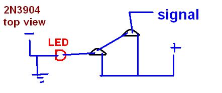

and yes, my transistor circuit is correct, i tried it with some infrared receivers and a TV remote
You can light a LED with 1mV and 2 transistors. . . . . don't say your transistor circuit is correct.

here's an ILLUSTRATION of the transistor circuit :p and the circuit diagram, plz do check them

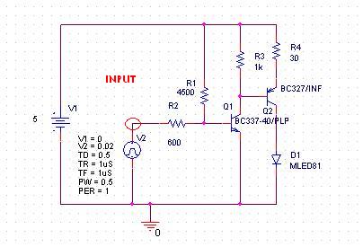

Your transistor circuit will only work if the input voltage is above 3.4v (2 times 0.7v for the transistors and 2v for the led) and even then you'll kill the led instantly since you have no current limiting. Basically, you're doing it wrong, transistors can be used to amplify incredibly small signals to as high as you want.
[EDIT]
I seriously doubt that your signal level is that low and it sounds like you'll probably be better off with an op-amp or comparator but here's something you can play around with.
