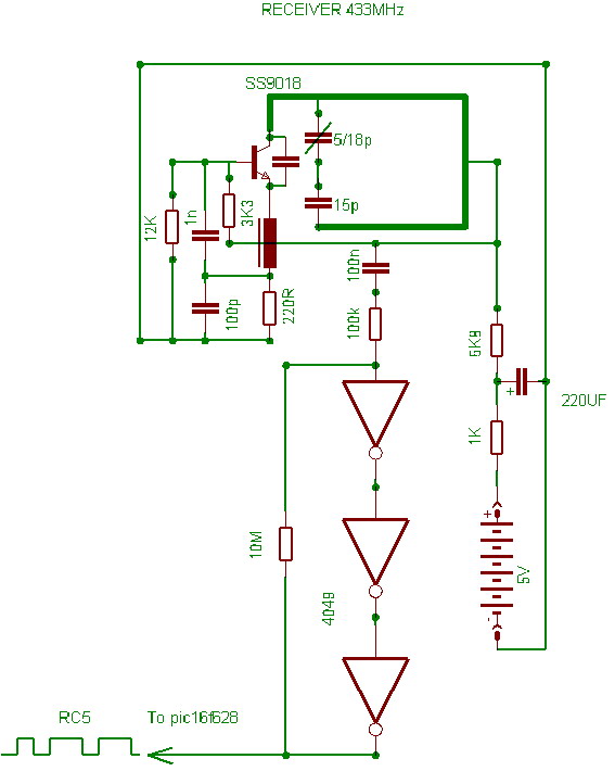

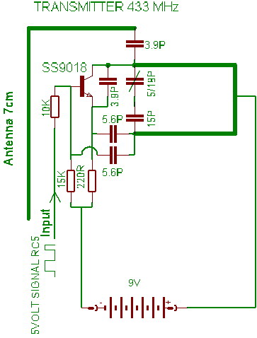

This is my problem in detail...
I build a project IR remote control transmitter and receiver RC5 protocol with PIC16f628, and I want to make it RF remote control with digital ICs and transistors.
In the transmitter I send the signal with transistor ss9018.
In the receiver I process and amplify the signal with 4049.
But the signal distorts so that the led in my receiver that indicates that signal received run and refer to it's not RC5 protocol and the (PIC) receiver ports didn't response !!!

Post the circuit for both transmitter and receiver - but I fail to see how you can expect to build a 433MHz receiver using a CMOS buffer?.
Also have you built them on correctly designed PCB's? - layout is absolutely critical - and I get the horrible suspicion that (like everyone else!) you may be trying to build it on breadboard?.

This is my schematics:

Yes, but the receiver itself uses another ss9018, NOT the CMOS buffer, that's just to give a logic output.
How have you built and aligned it?, like I've said previously construction is absolutely critical, and as crude free running LC oscillators they will require tuning to each over.
Even though it is 10Meg the resistor around the 4049 gates may cause oscillation, try a very small eg 10pF capacitor to ground on the 1st gate(closest to RF side)
