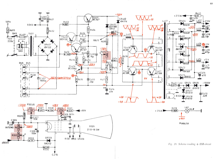

6. I’ve posted a Philips Pm3200 type, using a D10-16 CRT. It has a 1500 volt HV supply. It uses AC187 transistors to switch the SMPS, so you can see it is an old design. A round CRT face I think.

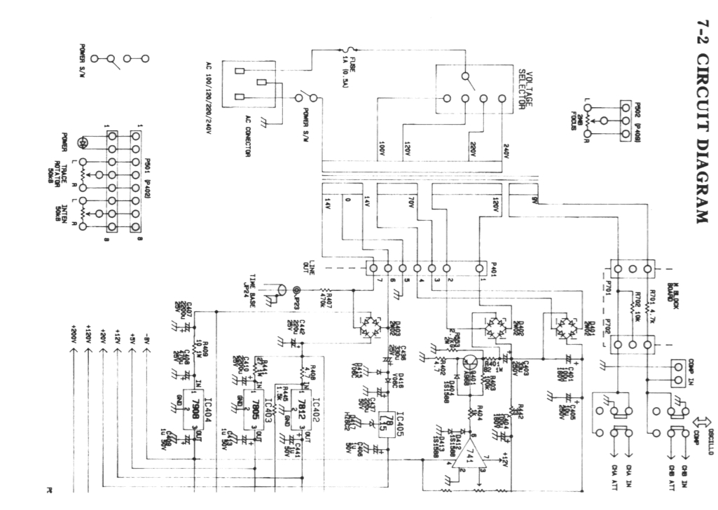

7. Posted is the power supply for a BWD 820 CRO. BWD was an aussie company that tried to be a TEK. The 820 uses the 130BTB CRT.

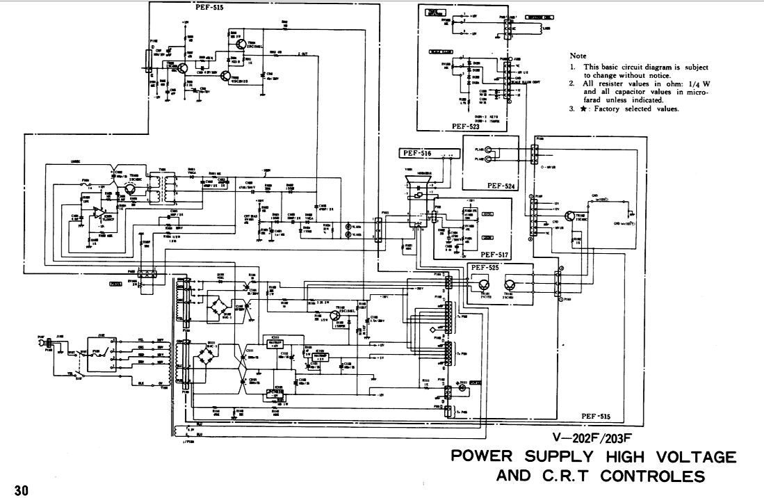

8. Posted also a Hitachi V202 power supply. Again, the CRT heater is biased to the HV supply. The CRT is a 140BMB31R

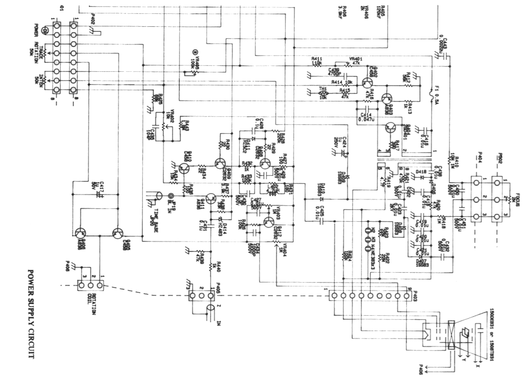

9. Protek P3502 power supply is on 2 sheets. The CRT is either 150BTB31 or 150DEB31. The Protek uses a SMPS for the HV supply and the CRT heater.
