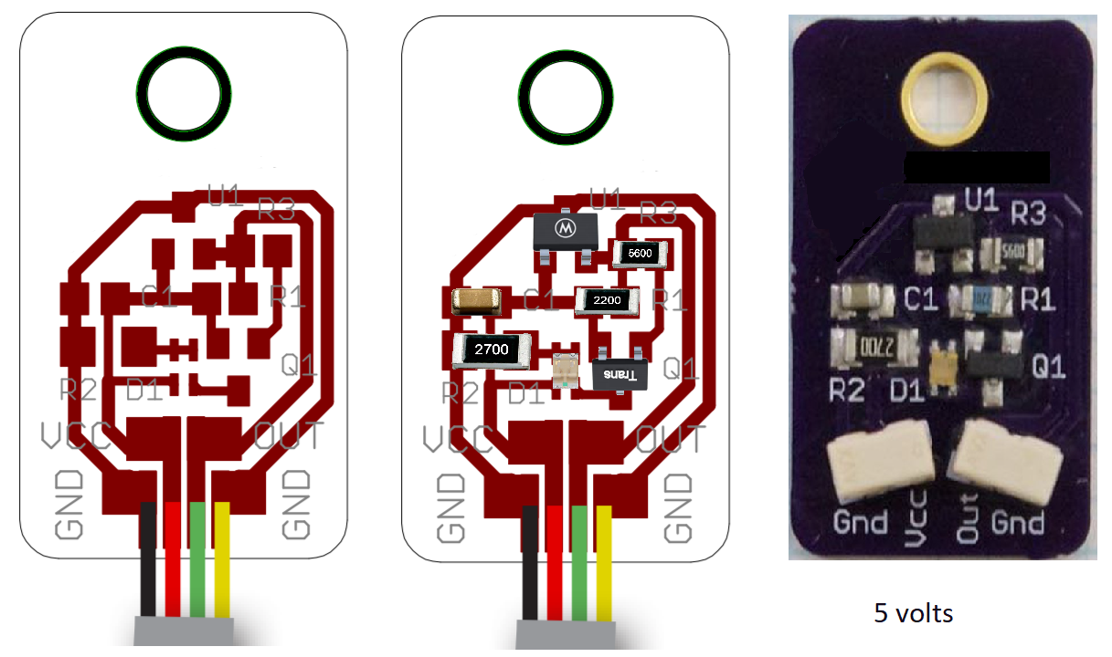

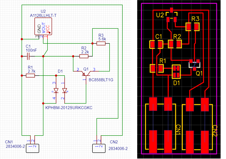

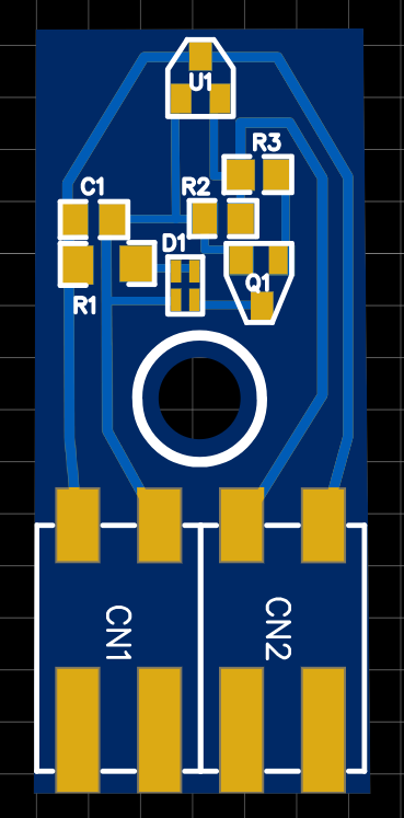

never to late I'm still learning , i ordered my first board with no masks and they came back and told me to cancel the order so i learned to add solder and paste masks, and i made some design changes. which lead me to this, and its being made now.
I think you're going to have a terrible time soldering that board together without solder bridges. I'd move the components much further apart.
I'm surprised that you've gone for such a different shape.
I would have expected the positions of the hole, the LED and the Hall sensor to have been constrained by the rest of the machine.
As far as the electronics goes, the shape makes no difference.
for my first board and 20Euros, if its a disaster i can put it down to learning and try again. the Hall affect sensor i wanted as close to an end as possible so that I'm not limiting travel for an axis. I moved the hole to the center so one it screws into the 80/20 or Rexroth style extruded aluminium it would put even pressure on the board against the aluminium.
I purchased the mask with it so, i was going to try and use my rework hot air gun to attach the parts with solder paste T5. I guess i need to be sparing so i dont get bridging.

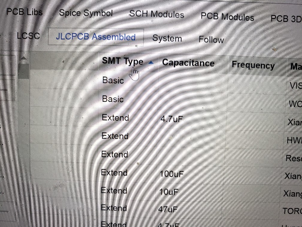

See my reply about using JLCPCB's assembly service if it doesn't work out (satisfied customer here) and post your board for review before you send it to be made.
The first time I tried their service, I paid less for the assembled boards than I would have paid for bare boards and a solder stencil (which I presume is what you mean by "mask").

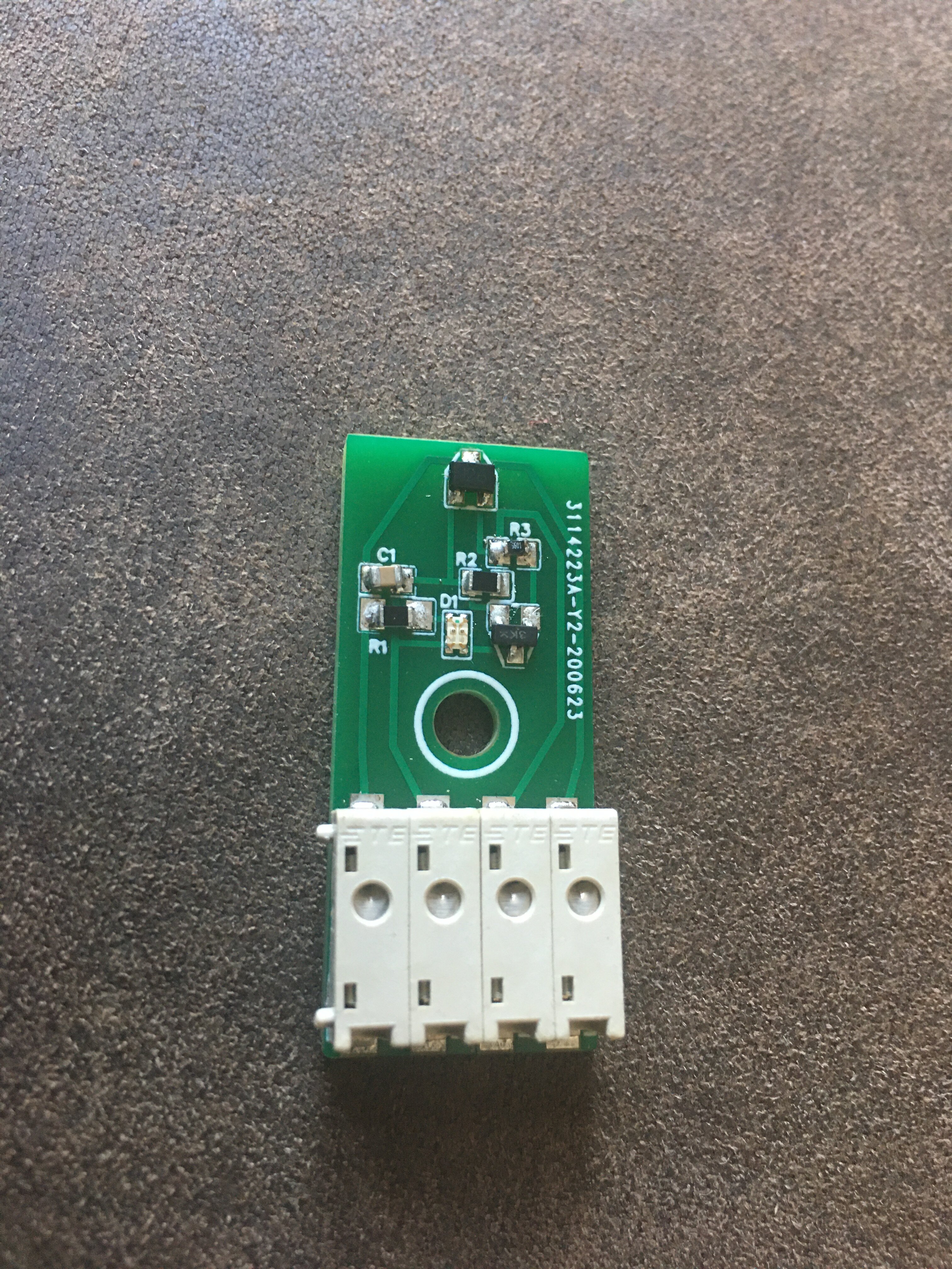

I just finished my first one, i learned a few things, i think i over heated the connectors and melted something i pushed a wire in and it does not stay in.
But i was able to see the green LED light up and when a magnet comes close it turns red
it maybe to sensitive, as it can detect the field from 60mm away, although i was using a neodymium magnet.
Any advice on the soldering i didn't order a mask so i used a very small screw driver and dabbed a very small amount of solder paste onto each connector, and then use the rework hot air gun to re-flow the solder
