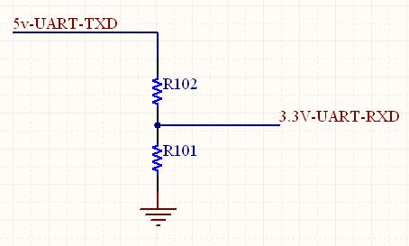

Hi, could someone help me with the maximum speed attainable(baud rate) with following scheme;

It is obvious that Resistive divider(within limits.... I dont mean MegOhm) is used to bring down 5V to 3.3V
I apologize for being glib.
The voltage level(s) will have no effect on baud rate, which, as I said, is limited by the slowest UART and if the receiving UART is a 3.3V unit.
Now, if what your asking is "will a reduced TXD voltage level (from 5 to 3.3V) effect a receiving UART expecting a 5V signal, then yes, the speed would have to be reduced as well.
This would be because the received signal level may very well be too close to the "is it a '1' or a '0' " threshold, thus requiring massive CRC checking. Or, at worst, not be able to successfully decode the analog signal correctly at all.
Is this what you were asking?
The max baud rate will depend on the capacitive loading on the voltage divider tap. If, for example, you were to put the divider at the TX, and the RX were to be hundred feet away on a twisted pair that has a capacitance of 50pF per ft, then you would have to consider the low-pass filtering effect of shunting the voltage divider tap with 5000pF. A sim of this case at 115KBaud shows the voltage at the RX as a function of stepping the resistance values in the voltage divider as R = 500, 1K, 2K, 4K and 8K. In the example, I would say R=500 and 1K would work, but R>=2K is getting marginal. You will have to recalculate based on a realistic estimate of your line capacitance.
ps, it occurs to me that the RX has a line terminating resistance which appears in parallel with R2 in my schematic, so you will have to consider that as well. Also, if you put the divider near the RX, then the line termination could be combined with the divider.

It dose have some effect , for which I was not sure . I think MikeMl is pointing it..

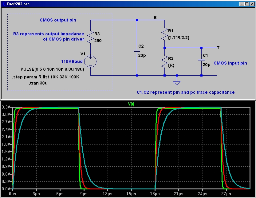

Please note its just a UART connection between an RF module(5V UART- TXpin) and my MCU Atxmega128's(3.3V USART-RXpin) and not RS232. I think capacitive loading should be in order of few pico Farads. Rgds
Mike in your simulation is the digital source using push/pull drivers? Or it is just sourcing 5v in the ON period and then open circuit (and not sinking current) in the OFF period?
The signal source is a Voltage Source with a zero output impedance, meaning that when it is at 0V, it sinks current out of the capacitor. A zero output-impedance voltage source is not a very good sim of a real TTL or CMOS output, but is close enough when the current being sunk/sourced is less than 10mA = (5V/500Ω). I did model a finite rise/fall time at the voltage source (see the two 100n parameters).
Note that a real TTL output would have asymmetric source and sink capability. CMOS has almost symmetric source/sink. Both of these can easily be modeled, but for a quick sim to make another point, the way I did it is sufficient. The trick is to know when you can get by with a simplistic model, and when it makes a difference so that you have to use a more complicated one...
Likely 5V CMOS output to 3.3V CMOS input. The total capacitive loading would be the sum of the output pin capacitance, the pc traces, and the input pin, likely about 20pF on each side of R1. I sim-ed again at 115kbaud, stepping R2 from 10K to 100K. If this was a battery-powered CMOS circuit, you would likely be interested in making R1, R2 as high as possible. Even 100K would work...
Thanks , this gives the confidence to go ahead.

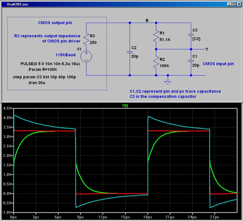

You would have to "tune" it to match the parasitic capacitances. Here is the sim again, this time stepping the compensation capacitor C3 from 10pF (undercompensated), 40pF(just right for these parasitics), and 100pF (overcompensated, peaking).
Unfortunately, you can't tune it directly with a scope, because the probe capacitance is of the same order of magnitude as the stray. I have done this by connecting a 1pF cap between the node in question and the probe. This reduces the probe loading to <1pF, obviously.The amplitude will be wrong, due to the capacitive divider, but the wave shape will be correct.
