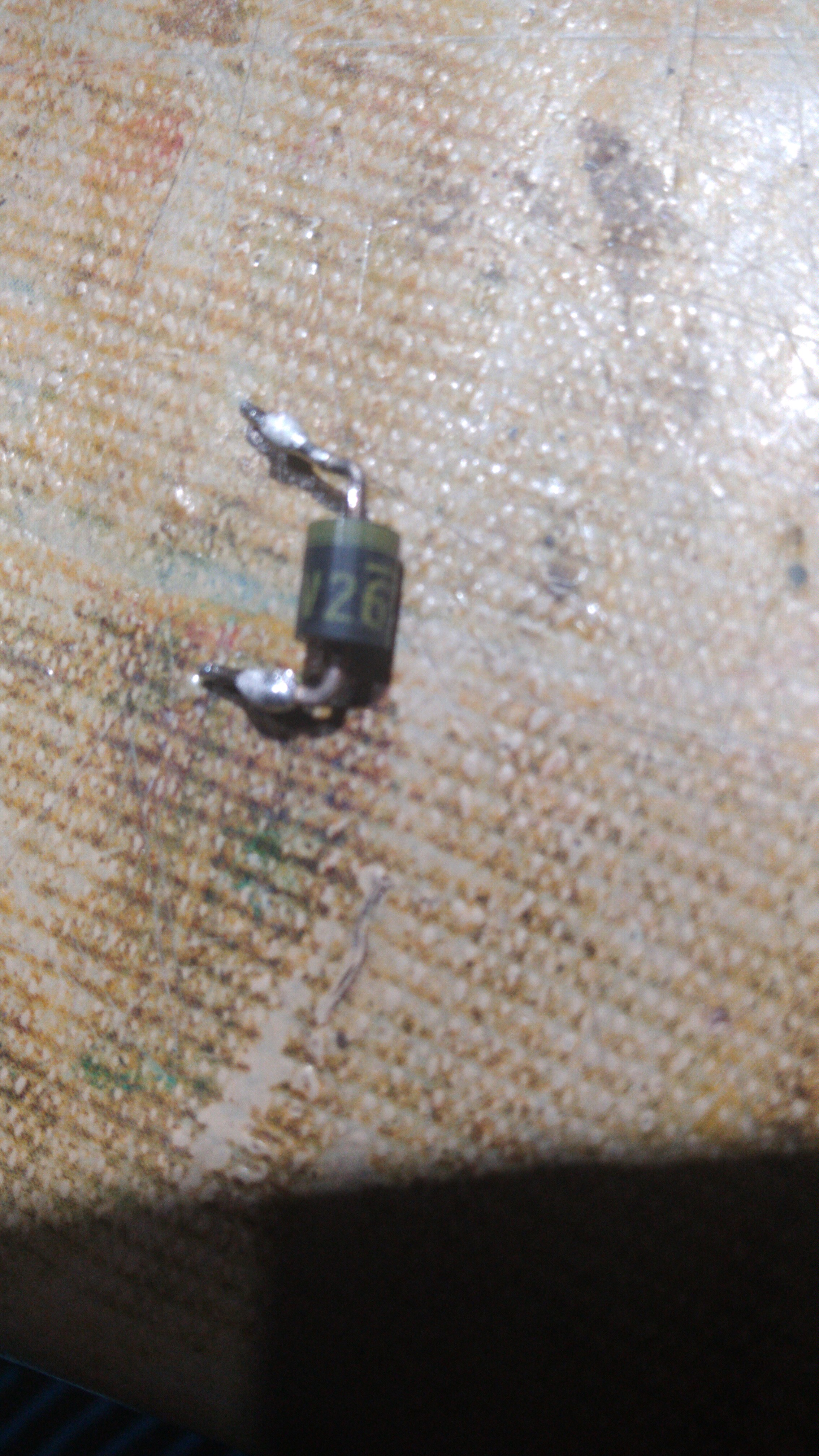

Hi all
Where can I get the datasheet of GV267 diode. Its showing open in both direction. Its a Sharp -notevision LCD Projector power supply part.

A picture might help ?
Woww through hole! After the 26 is that a manufacturers logo ? can you picture it too ?
Have you got the service manual or a schematic ?
That rather depends on what kind of diode it it - not all diodes will read on a meter.
Do you have any idea what it does?, and how did you come to suspect it?.

I check the diode with a zener diode tester, its shows an open diode. Not conduct with voltage. If Anode is possive, no voltage is at cathod in the range of 1.5 volt to 56 v DC.
1. Its not a zener diode, no action detect as a zener diode - may be its open.
2. Its not a normal diode, no action detect as normal diode.
It used in the high voltage section, in the high voltage lap section. I trace the PCB and think its just like to get a feed back when projector lamp light up.
The problem of the projector is that when turn on the projector, all fuction are ok, but turn automatically after a few seconds.

Possibly a high voltage avalanche diode of some kind?, to detect the lamp is working properly?. 56V sounds like it could be far too low to test it with.
I presume you've changed the lamp?.

The projector working last two years without any problem. Only problem detects as it fuse blown and MOV burned. I changed the faulty parts and projector works. But the problem remain continued....
I need to identify the diode and changed, maybe it would be work
Google doesn't find any hits on that number, so it's probably an in-house number, so would need to be sourced direct from Sharp - assuming they would even supply parts.

Get the service manual and its not a diode. Its a SIDAC...
So I think I can repair the projector.

Hi
Ohhh... Sorry.. I forget to mention that.
The GV267 Is working.. Not fault.
Fault is with the cooling fan. Q1721 the driver for the cooling fan, faulty and may work the projector when I changed. Waiting for the part from the local store near by me.
