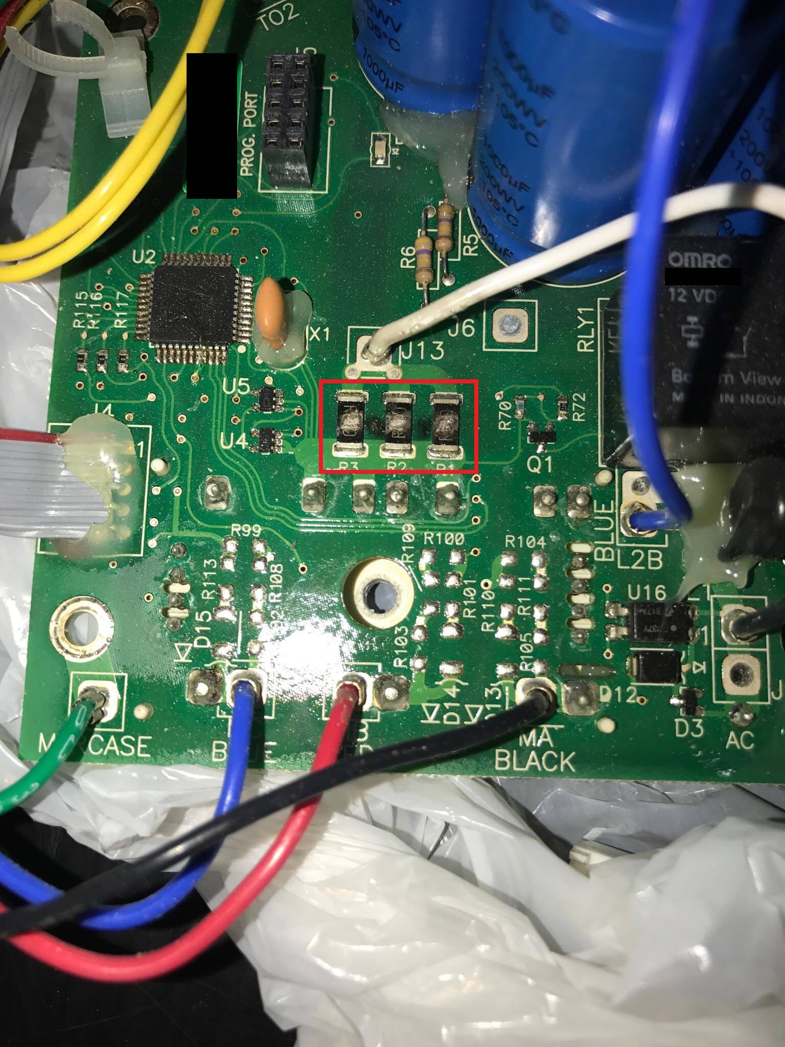

A neighbour has asked me to help repair a broken pcb for a large cement blender. I have found three burnt out components; but the number on them is not visible and the company won't provide me a schematic.
Suggestions? What should I try doing?
Only have a few days to repair this.
https://imgur.com/a/brYjBCL
Cheers

They are low value resistors (less than an ohm each, but that's all you can tell) - presumably they are used to monitor current?.
Do you have a low ohm-meter, so you could check them - they 'might' not be faulty, just over-loaded somewhat and discoloured.
There's also no guarantee replacing them would cure the problem, as it could be a fault elsewhere that's drawn too much current.
Since they are all less than one ohm, you can try something like three x 0.47 ohm one watt resistors (carbon-type) from your local shop. This is called "middle of the road" decision.
Resistors do not burn on its own. They burn because something else caused them to fail.
So I agree with Nigel. You could "fix", the problem, only for the resistors to burn up again if the original condition which caused the overload persists.
It's not a good idea to guess the value. As Nigel said, they are likely to be used to monitor the current, so if you get the value wrong, the processor (U2 in the photo) will see the current as being too big, and turn off the motor (or other load) when it shouldn't, or not see the current as being as large as it is, and not turn off the motor when it should.
Resistances that low are difficult to measure, as the resistance of multimeter leads and contact resistance can make big errors. You should use a 4-terminal ohm meter. As those are expensive and rare, and the resistors may well be damaged anyhow, I would suggest that it might be easier to find a similar cement blender and get a photo of the PCB. The resistance values are easy to read from resistors that large if they aren't damaged.

Indeed very likely that something else has failed and blown these resistors - so probably best try to find out what it was before investing too much time trying to identify the resistors.
What's opposite them on the other side of the board? There are some big pins coming through and what looks like a hole for screwing a tab to a heatsink - the pattern of the pins is unfamiliar though.
It's likely there is a big FET or IGBT blown in there somewhere - so probably best looking for that first.

I do have a low-ohm meter, but no replacement resistors. Probably not worth importing some, if the issue is likely to be elsewhere?
