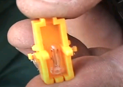

This is what bulb looks like
I'd prefer to use LED diode instead of T1 because they can last longer.

Be aware that most of the light emitted from an LED comes from the domed end of the LED package, as a narrow beam.
An incandescent lamp as shown in post#5 emits most of the light from the sides of the cylinder shape, in an omni-directional pattern.
Replacing the lamp with an LED may not give the result that you require.
Is there enough room in that housing to use eg. three 3mm LEDs in series, such as with the leads on each bent 90' out, trimmed and soldered directly to each other?
That gives three times the light for a given current and reduces the voltage across the series resistor, so that is producing less heat.

That's commonly called a "grain of wheat" lamp. it's a filament lamp. Essentially what you have.
It depends on which way the light has to face. From your pic, it seems it has to face toward the paper. the lens will mess it up. So, yellow LED with yellow lens. there might be some right angle LEDs or axiel leds that can work. Just size R correctly.
