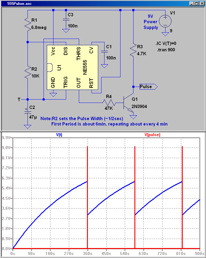

I am just learning this stuff. I know I need to use a 555 timer chip most likely.
I need a circuit that will repeat a pulse once started and continue to pulse until stopped. I need to be able to adjust the time between pulses from 1sec to 15 mins. The pulse will be needed to fire an electromagnet of a sort to do small mechanical work.
Jim

starting and stopping starts the pulsing.
The length between pulses could be as low as 1sec-5mins, more then 5mins would be nice.

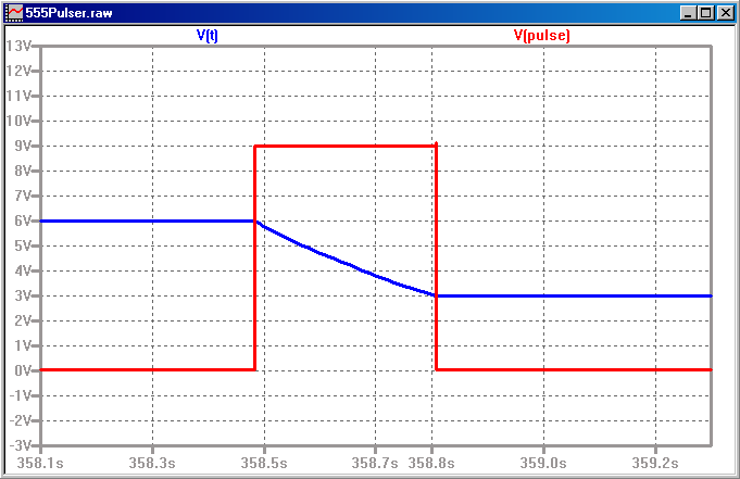

The time length of the pulse would be about .5sec, just enoff to trick a switch.
Those circuits wont do like what I said, I have had a good look around, with no luck.
Jim
This circuit I posted in this thread comes real close to what you need.
Is your pulse high for the short duration? If so, you would have to reconfigure the output transistor.
