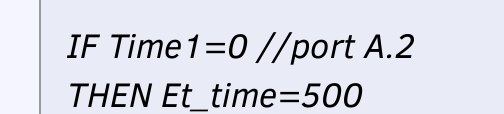

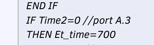

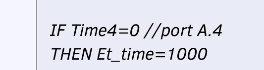

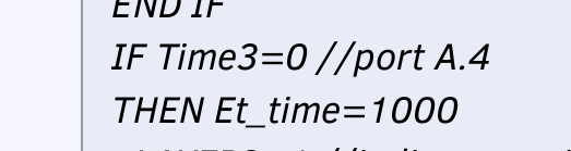

the switch is a 4 position switch pin 1 = Time1 pin 2 = ground pin 3 = Time2 pin 4 = Time3 pin 5 = ground pin 6 = Time 4
here is the code that I used to verify that I have a hardware issue and not a code issue. Is what is occurring is when the rotary switch is set on Time4, the position 4 (player4) led is enabled, the two green then two yellow leds are enabled in sequence. Then the Mst_led is enabled ,then the code jumps out of the loop and player10 led is enabled to indicate the sub has ended. In the Time1 _ Time 3 sequences the code does not jump out of the sub UNTIL the Master_swt is depressed.
basic code
sub et_select()
REPEAT' master_swt=1
IF Time1=0 //port A.2
THEN Et_time=500
DELAYMS(500)
pLAYER1 = 1 //indicates switch position
Green1=0 //500ms time1
DELAYMS(Et_time) //5000ms time3
TOGGLE(Green1)
Green2=0 //500ms time1
TOGGLE(Green2)
Yellow1=0 //3500ms time1
TOGGLE(Yellow1)
Yellow2=0 //500ms time1
TOGGLE(Yellow2)
MST_LED = 1
DELAYMS(500)
TOGGLE(MST_LED)
DELAYMS(500)
pLAYER1 = 0
END IF
IF Time2=0 //port A.3
THEN Et_time=700
pLAYER2=1 //indicates switch position
TOGGLE(Green1)
TOGGLE(Green2)
TOGGLE(Yellow1)
TOGGLE(Yellow2)
MST_LED = 1
DELAYMS(500)
TOGGLE(MST_LED)
DELAYMS(500)
pLAYER2 = 0 //turn off position led
END IF
IF Time3=0 //port A.4
THEN Et_time=1000
pLAYER3=1 //indicates switch position
TOGGLE(Green1)
TOGGLE(Green2)
TOGGLE(Yellow1)
TOGGLE(Yellow2)
MST_LED = 1
DELAYMS(500)
TOGGLE(MST_LED)
DELAYMS(500)
pLAYER3 = 0
END IF
IF Time4=0 //port A.4
THEN Et_time=1000
pLAYER4=1 //indicates switch position
TOGGLE(Green1)
TOGGLE(Green2)
TOGGLE(Yellow1)
TOGGLE(Yellow2)
MST_LED = 1
DELAYMS(500)
TOGGLE(MST_LED)
DELAYMS(500)
pLAYER4 = 0
END IF
' MST_LED = 0
'DELAYMS(1500)
UNTIL Master_Swt=0 delayms(500) //exit routine
end sub

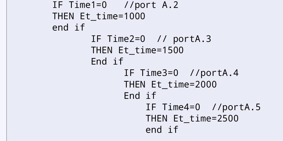

I think you are confused. First program listing:
Lastest program listing (impossibleto read -FORMAT!):
Of course, nobody can tell what you're doing because you haven't included your code with the dimension statements, whether you used SetAllDigital to switch Port A to digital, whether you are erroneously writing to input ports, etc.
If you can't even take time to make your code readable (which will help YOU keep track of things) why should anybody else take their time to decipher it? You could start by putting your if/then statements in the proper conventionsl format.
