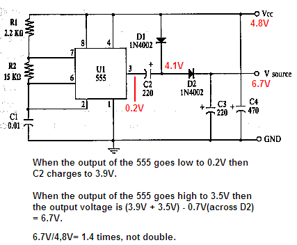

Here's a circuit drawing of the 555 which I was thinking of using. Would it work?

The 555 circuit has some flaws; mostly if Vc is greater than the turn on voltage of 2 LEDs in series they both will be on without current limiting.

The 555 can double the output voltage, but the resulting current will be 1/2 (no new power created). And, the 55 driving the LEDs would make them flicker like you want, providing the Vs is less than 8*Vf of the LEDs.
But neither circuit will create energy. All of your energy must come from your solar cells.
I should correct that: The 555 requires 4.5V input before it can double anything. It cannot double 1.2V from a NiCd or NiMH.

The 555 circuit does not double the voltage because its output has a 1.5V loss and the diodes add another 0.7V loss.
The battery must be higher than 4.5V so four Ni-cads can be used to give 4.8V.
The output voltage from the "doubler" is only 5.7V at low currents and is less at higher currents.
White LEDs are about 3.5V. Two in series need 7V but the doubler circuit does not supply enough voltage.
A Cmos 555 works with a supply as low as 2V but its output current is very low.
The Maxim IC will work if you have 2500mAh Ni-MH cells and a huge solar panel.
