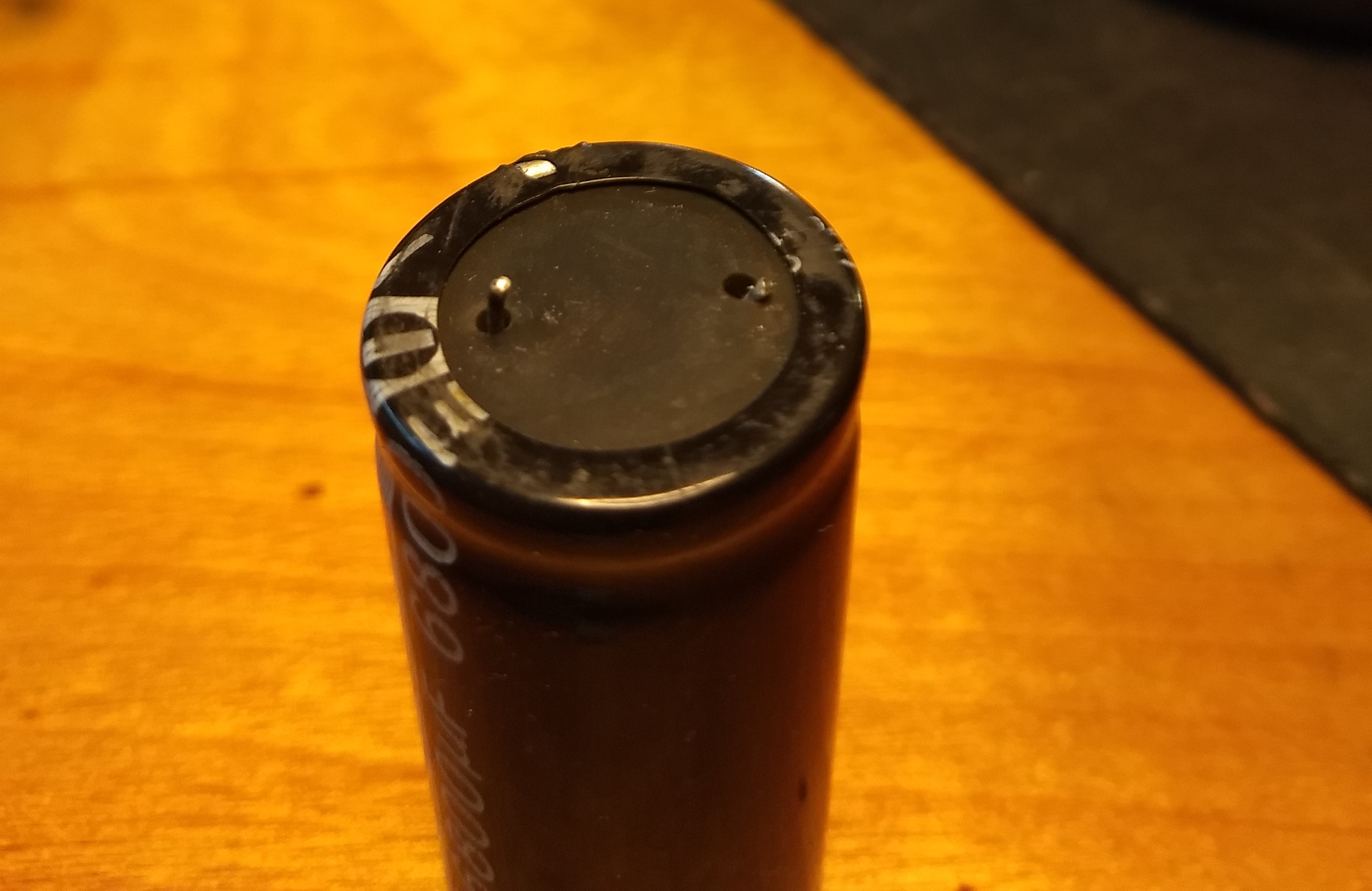

I have a Kustom 200 watt guitar amplifier head, it's several years old. When I plugged it in to test a new set of speakers I had built, it seemed to power on, but I couldn't get any sound out of it. (lights came on, all the channels seemed to be selecting properly, etc..) I opened it up, and found that one of the capacitors on the power board had completely fallen off the board. The positive pole wire was broken off to about 1/32 of an inch long, and the negative wire had apparently come unsoldered from the board. These are Aluminum Electrolytic Capacitors, 6800uf, 63V. The question I have is: What could make the capacitor fall off the board like this? I've included a picture of the capacitor with the broken pole wire. It isn't swollen, and it's not leaking...actually looks like it is in good shape, but I know looks can be deceiving in components like this! :) I did not test it, as I decided to just replace both of them with new ones regardless. (there are two identical ones on the board).
I already have the new capacitors, they were relatively easy to find at Digi-Key.
I'm a little concerned that there might be some other component on the board that caused the problem. I have really looked the board over closely, and it doesn't appear to have any obvious damage, but I know sometimes there can be damage without anything showing signs. The capacitors aren't really very expensive, but I would hate to replace them just to have the new one get damaged right away.
Thanks for any help anyone can give me with this!

There's nothing to go wrong to remove the capacitor from the board - it's purely physical - and probably the result of the amplifier been dropped (probably many times over the years), and it's simply mechanical damage.
There's no signs of any glue on the capacitor, they are usually glued in place to prevent this.
Basically it's a question of replacing the capacitors, and seeing if it works - it 'may' have caused further damage.
Assuming it then works?, then run some hot melt glue round the bottom to secure them to the board.

Exactly what Nigel said.
Nowadays you will see that all large electro caps are firmly attached to the PWBA, usually with hot melt glue or a bracket.
Unless they are secured, their usual tall profile will put a lot of stress on the leads, leading to metal fatigue and failure.
Also, Kustom amps were guitar amps, correct? If so they will have received more than its fair share of abuse during its life on the road.
Thanks schmitt trigger! Yes, this Kustom amp is for Lead Guitar, and apparently it did indeed have it's fair share of abuse!!, The amp is now working perfectly now though! I did add some hot glue to the bottom of the caps this time, so hopefully they won't just fall off anytime soon!
On another note though, after I got them soldered on, I did notice that the new caps were rated for max 85 degrees, while the originals were at 105. Since this is 4x more lifetime than the 85 degree ones, I have already ordered the correct temperature ones and will be replacing them in the next few days.
