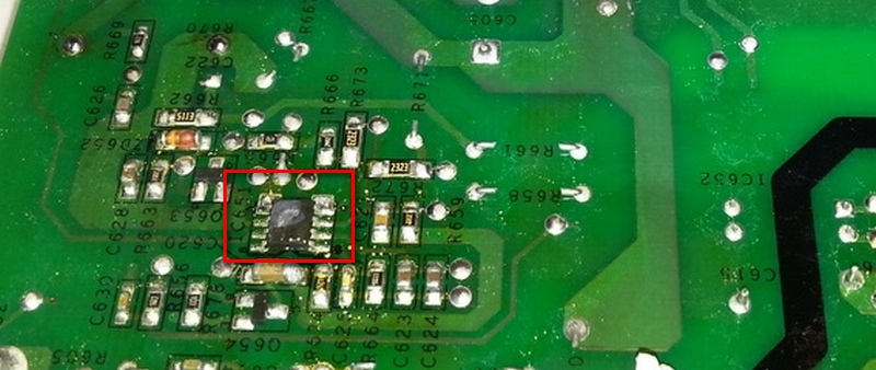

I have an LCD with what appears to be a failed internal power supply.
I immediately identified a blown 0.22 ohm resistor. However, it was pointed out by ronsimpson in a different thread https://www.electro-tech-online.com...-where-can-i-salvage-one.149286/#post-1276833 (I created a new thread because this is a repair topic and the previous thread was just regarding the type of the resistor and where to salvage another one) there might be other components that caused this, so simply replacing the resistor might do nothing except ruin the second resistor.
Maybe the resistor is not needed just for testing? Maybe someone has some advice for how to bypass this part of the circuit to see if it will work without it? Or would that be foolish?
There were two resistors, only one had failed, I removed both. In the pictures below they are both missing but I have marked the locations where they are supposed to be in one of the pictures.

You should test the two transistors (MOSFETs). Do a quick ohm-meter test. Do they measure about the same?
They are fusible safety resistors, as indicated by the serrated box around the component designation on the board. There will be a reason for failure, check the circuit section the failed resistor was feeding. I have known them to fail just due to age or from a surge. However I do not recommend just shorting one out, (These resistors are required safety components) nor simply replacing one (use same type) without first doing a check on the fed circuit section. Google for a Circuit diagram of the PSU board, (the number on the board looks to be 4H L2K02 A01 ) I will look later to see if I can help. Use the diagram if you find it to trace what the resistor is protecting, and what may have caused it's demise.
The diagram is here if you need it. https://www.scribd.com/doc/207782153/Dell-2407-WFP-Power-Supply-Rev-A11-Schematic-Diagram The two resistors you refer to are protecting two MOSFETs. R670 on Q561, R615 on Q601. So depending on the identification of the failed resistor I would check its associated MOSFET and circuitry.

The bad resistor was the one nearest the mains input.
I found that its neighbour K3502 MOSFET has a short between its drain and source. So this part is defective.

The new resistor exploded immediately when connecting mains power.
The transistor however appears to have survived.
I noticed that there appears to be something leaking from a 450 volt capacitor. If this cap is bad, could it be the cause of the resistor failing? Or is that an indication of something else?

Just looking thru this thread, sorry to butt in here but from your first post, your last pic shows this power factor chip L6561 on the back side of the board to have exploded and it controls that FET and is fed by that resistor. It either took out the fet or was collateral damage.
need to be checking all components that are connected to it.
added: like r669 from the .22 resistor and Q654 on the vcc pin

These psu have a common failure mode. The main filter cap dies, which causes a domino effect, taking out a mosfet and usually two ICs on the reverse side of the PCB, plus of course the odd resistor or zener diode.
Snips of info, That resistor shows a high volt/speed destruction, as aforementioned the main filter caps poles could be fused at the base resulting in rectified mains power bypassing that cap and producing a reverse bias like effect on the affected parts, hence the burst IC, DC/DC driver and the fast pace fail on the new resistor. Not sure of the transformers status as the FET went and if had any cycle load effect on the winding long enough before the FET failed that would have heated the enamel to have cause any type of short within the transformer itself. Dropping back now, as I don't want to cause the affect of too many chefs stirring the pot.

I replaced the MOSFET, the main filter cap, the power factor chip (L6561) and the R670 fusible resistor.
Giving it mains power immediately destroyed the R670 again. It seems the MOSFET is also broken again, but it seems the L6561 survived.
How should I proceed to repair this? Do I need to desolder all of the diodes and resistors and test them by hand?

Sorry to not be very helpful, but you need to replace ALL faulty (damaged) components - or (as you have found) it just goes BOOM!! again.
I've no ideas on this specific monitor, but 'back in the day' I created parts kits for common TV's, VCR's etc. with dead PSU's. They varied depending on the model, and what commonly died. Interestingly, where wibble mentioned the main filter (reservoir) capacitor failing, this only causes failure on some PSU's - others, even using the same IC, seem to survive quite happily - and even work 'fairly well' with a completely O/C reservoir.
Common parts in my 'kits' were the IC, the FET (transistor), a resistor or two, a few diodes (including zeners), and a couple of capacitors.
A less common failure was the actual transformer, either O/C, S/C between windings, or shorted turns.
